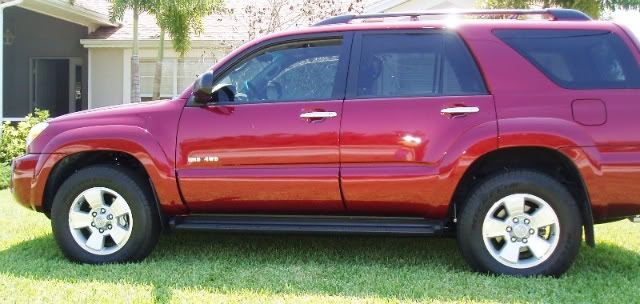

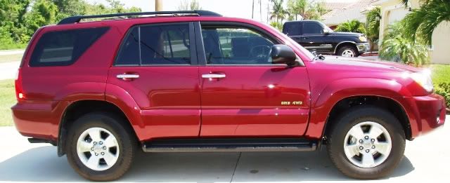

Not the best but you'll get the idea... 2 without the FJC springs followed by 2 with.
Even with the bike blocking the T4R you can really get a sense of the 'nosedown' OEM setup.

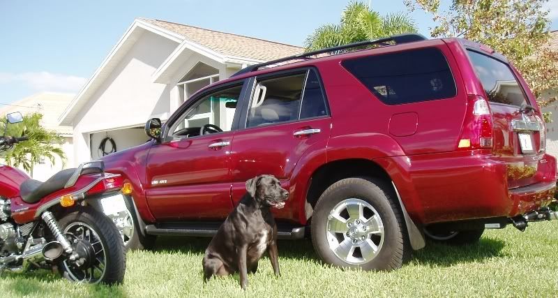

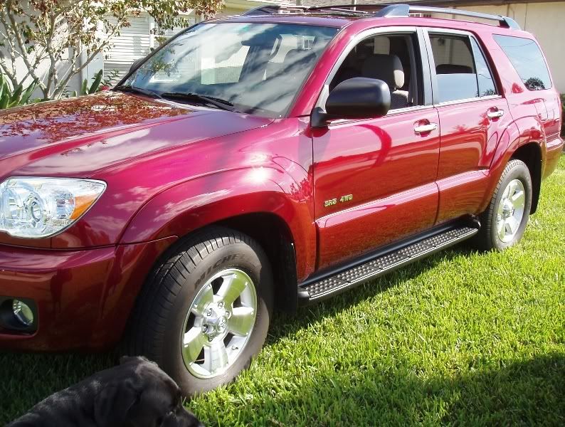

With FJC springs... Between then and now I got my AirLift 1000 installed too. As many of you know you must run at least 5psi at all times in the AirLift. Even though it's only 5psi I swear the backend looks a touch higher...
WithFJCsprings.jpg~original
In all fairness: The driveway has a slight upslope and as the T4R comes to rest on the p-brake the nose comes up a whisker.
WithFJCsprings1.jpg~original
