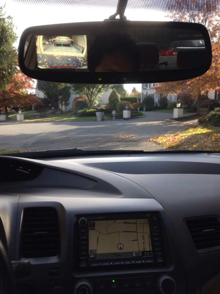

I installed a Gentex mirror with Homelink/HiDefcamera on my Civic, I love it.
