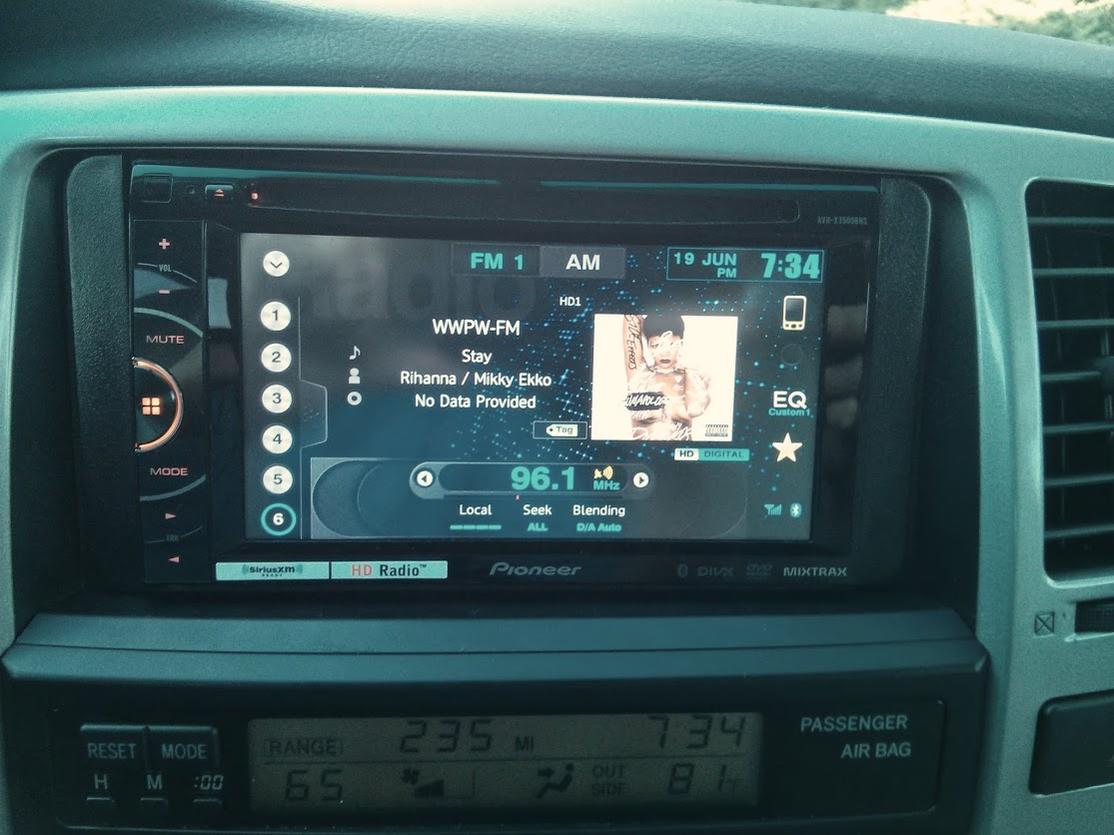

I have completed the installation of the Pioneer AVH-X3500BHS head unit in my 4Runner. I want to thanks all the people in this community who posted the information and responded to my questions. I couldn't have done this without your helps.

I finally decided with the Pioneer AVH-X3500BHS. The thing that makes this unit standouts from the other 2 was the Digital Radio. With digital radio, you get the CD quality from FM. I can tell the big different in the sound quality by switch between analog and digital. The station also passes over the song information and even album art (see attached picture). The volume button is a little difficult to press while driving but that's solved by installing the Steering wheel control. I installed the USB/3.5mm AUX Extension Cable to the center storage area, the same area the original AUX input was installed. This way, I can have my handheld equipment hide away. For the microphone, I posted a question to get input from this community. I ended up installed it under the rear view mirror. I want to install somewhere in the middle so that the passenger seat can engages to the conversation. My original spot was to drill a hole in the reading lights/sunroof switch and hide all the microphone wire away. However, that unit was molded together and I'm not able to drill a hole through it.
Some issues I had were the FM reception and the bypass switch. At first, I installed the bypass switch and it works nicely. Per instructions, I connect the black wire to the black on the harness, the blue to the blue/white, and the green to parking break wire on the head unit. Then I was having issue with the radio reception. After posting question here, I found that the 4Runner has an antenna booster and it needs to power up by connection the blue wire from the harness (power antenna wire) to the blue/white wire from the head unit. I left this out at first thinking there is not power antenna in this model of 4Runner. So the reception issue was fixed and I'm getting all the stations I got before. I few days later when my kids play a DVD, the bypass switch stops working. It turns out that by adding the antenna booster wire to the blue/white wire, the bypass quits working. I work around this by switching the antenna booster wire to the yellow wire from the harness (the ACC switch wire).

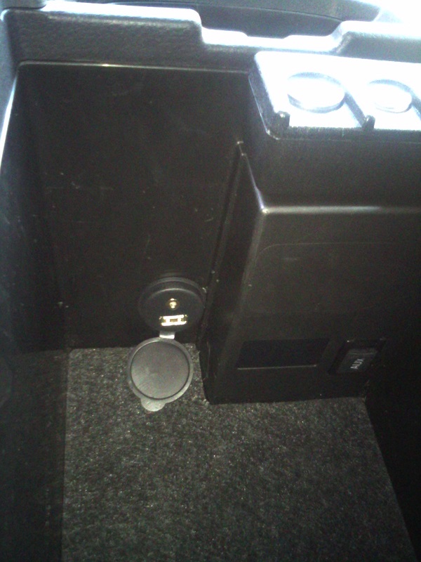

I didn't put the usb/3.5mm on the button. I put it inside the storage area where the 120v and the existing 3.5mm were. I had to take it all apart to drill the hole and make sure room for it behind.

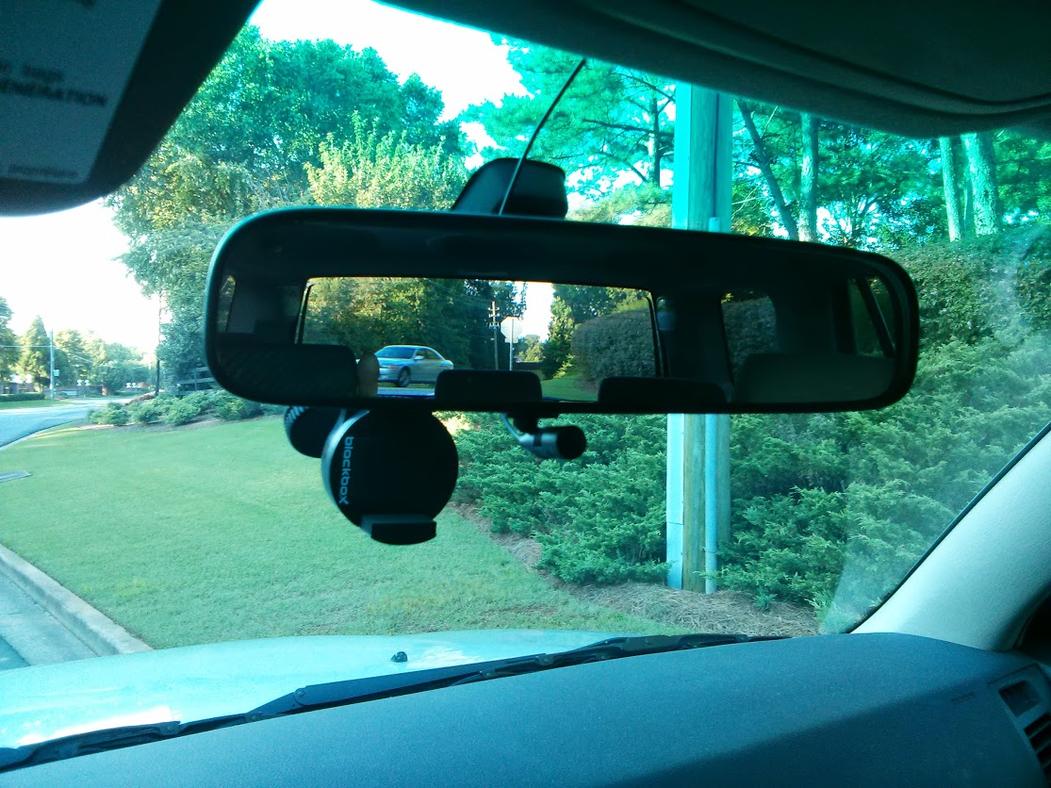

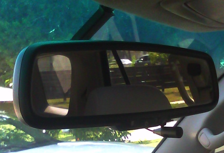

First off...I agree that the best position for the phone mic is on the rearview mirror. In this position, the phone mic is centered for the driver and front passenger, and it is in the middle from the side windows which could introduce some road noise. Next, I recommend that a bypass switch be installed with any backup camera to be used for towing. It was interesting that the DelCity supplied rocker switch fit into the blank hole without making the hole in the dash larger. It was a very snug fit. I tried installing the switch in a different empty hole, but it would not have installed there without making hole larger. Others that have installed this switch on a 4th Gen 4Runner have commented that they had to enlarge the hole.

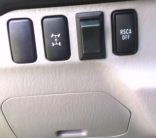

Possible helpful hint: I created a free DelCity account before deciding to order the switch. A few days later, DelCity sent me a coupon code for free shipping; so I got free shipping on the switch. :)

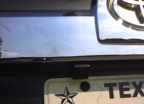

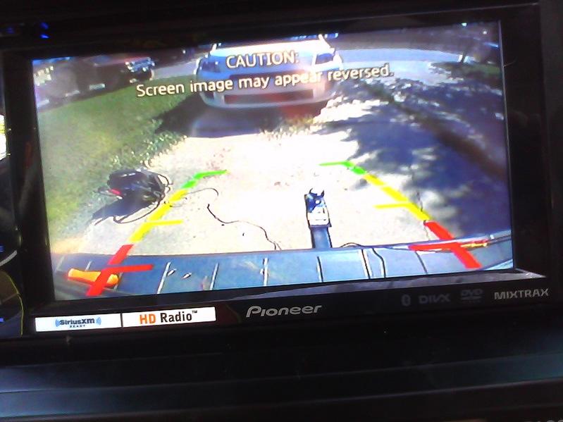

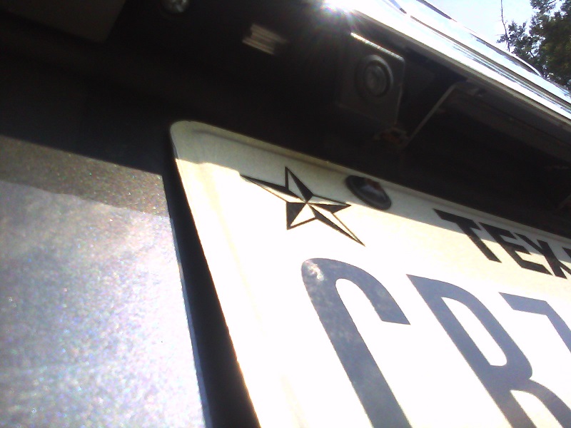

After unsuccessfully searching for a premium camera that was specifically designed for my SUV, I decided to try an inexpensive camera (~$20) on Ebay that claimed to be designed to mount to a 4th Gen 4Runner in the license plate light position. While the camera did mount in the license plate light position, plastic shims and longer mount screws had to be added to keep the camera from pointing almost straight down. In other words, the supplier could have made installation much easier by including the shims and longer screws since the camera was specifically advertised for this vehicle. While it was understood before purchasing, it should also be mentioned that it took ~3 weeks for the camera to be delivered since the unit was shipped from China. I'm hopeful the camera will work out for the long term; however, there was enough room to leave the Toyota OEM/stock license plate light (light bulb removed) inside the cover on the lift gate. If the camera needs to be switched to a different style of camera, the Toyota OEM/stock license plate light can be moved back into its position. Also, there is a significantly less chance of losing it by leaving on the vehicle. The license plate light with the camera is a LED light; so it should last for years. If someone on this forum decides to use this camera, please be aware that LED lights require that the polarity of the wires be correct to operate. Other cameras can offer infrared lights for night time use; however, the license plate and reverse lights seem adequate enough to see the blind spots. The picture quality is fine also. However if you are wanting to shoot movie clips with a backup camera, this camera may not be for you. It may not sound like it, but overall, I'm happy with this backup camera so far. The price was right and the premium cameras that I researched had less of a stock/OEM appearance.

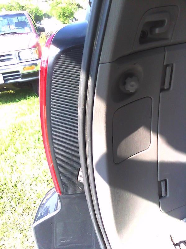

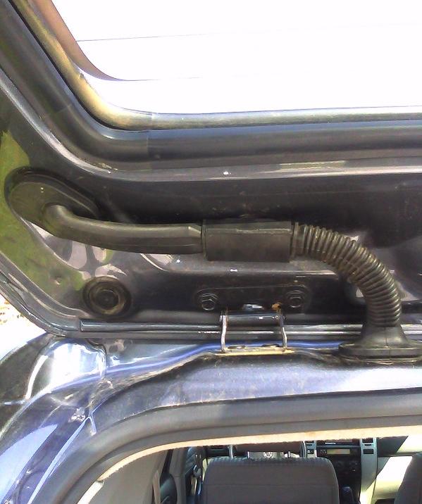

The backup camera cable run to the radio and the power antenna output on the radio caused me some frustration. The video cable that came with the backup camera was too short and the RCA connector was too large to be pulled through the rubber grommet between the lift gate and the vehicle. Long story cut short...the video cable was spliced and an extension cable was added. The pull strength on the video cable was not great; so a couple feet of the cable was damaged by the pulling through the lift gate grommet. I could hear the wire breaking inside the cable while pulling it through the grommet before the RCA connector was cutoff the cable. Even if the couple feet of video cable had not been damaged, the video cable was still too short.
Another item to mention...the power antenna output on the radio added noise back into the radio when the output was connected to the Toyota OEM/stock antenna amplifier (aka booster). The solution was to use the ACC power for the antenna amplifier which was suggested in another post in this thread. It was not an option to leave the antenna amplifier disconnected from power since the radio reception was terrible without it. If you are unaware, the 4th Gen 4Runner has something known as a diversity antenna (well...our 4Runner has this type of antenna anyways). It is actually 2 antennas with an antenna amplifier. The antenna cable into the stock radio has 2 inputs/connectors and a wire for power to the antenna amplifier. Some folks have reported that their radio reception is fine without the connecting the smaller antenna connector with the Metra splitter to their aftermarket radio, but I installed the splitter since the source of the noise was unknown at the time.
Has anyone else that has installed this head unit experienced noise issues with the power antenna output connected to the Toyota OEM/stock antenna amplifier?
I am considering adjusting camera to get more of the horizon into view
Sorry for the poor photo of camera, but I did not want to wait for a better light.
As you can see in this photo, the camera is somewhat hidden from view.
This a photo of the rubber grommet that caused me some difficulty.
The DelCity supplied SPDT On-On Full Size Rocker Switch looks OEM/stock.
The phone mic looks great too
This is a photo of the driver's side tail light. To me, this was the best place to splice into the reverse light power. A cable was attached to the reverse light power at this location and run to the Backup Camera bypass switch. The interior panels had to be partially removed to run the video cable and power for camera anyways.
The USB/3.5mm AUX Extension Cable was mounted inside the center console.
