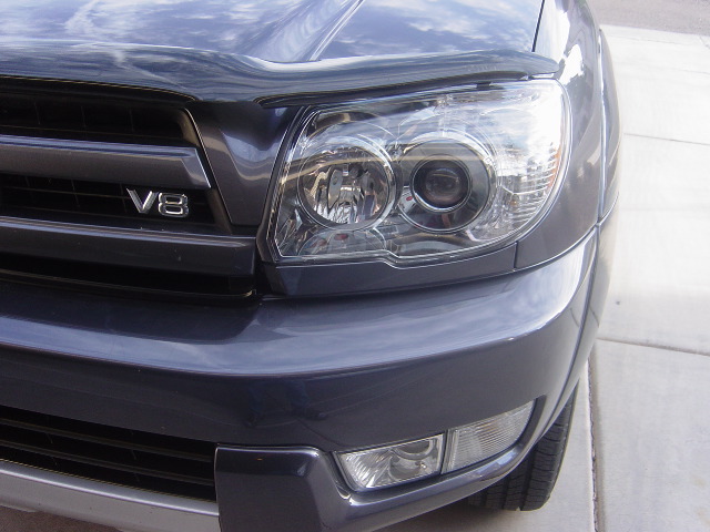

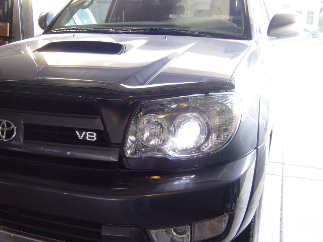

HID INSTALLATION PICTURES
HERE ARE SOME PICTURES THAT I TOOK OF MY 2005 4RUNNER WITH 2006 PROJECTION HEADLIGHTS AND PHILIP 5K HID'S
MORE PIC'S, STILL HAVE TO FIGURE OUT HOW TO FIX BOTTOM GARNISH
