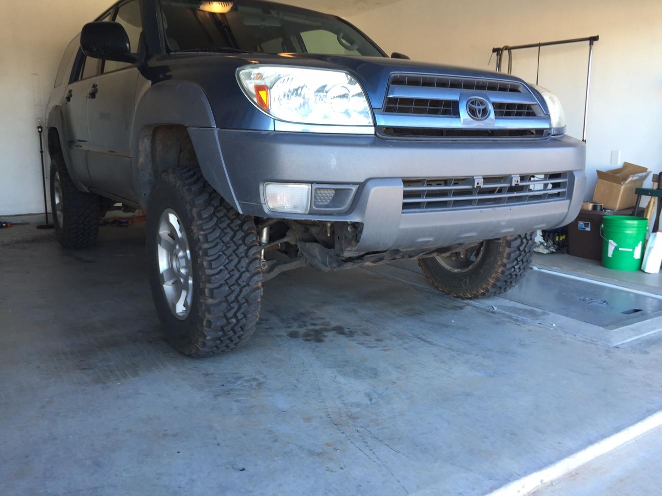

I would like to get some ideas for trimming the factory front bumper. Any extra clearance that doesn't break the bank would be useful to me.
Here are a few that I found around... Please add anyones that I have missed.

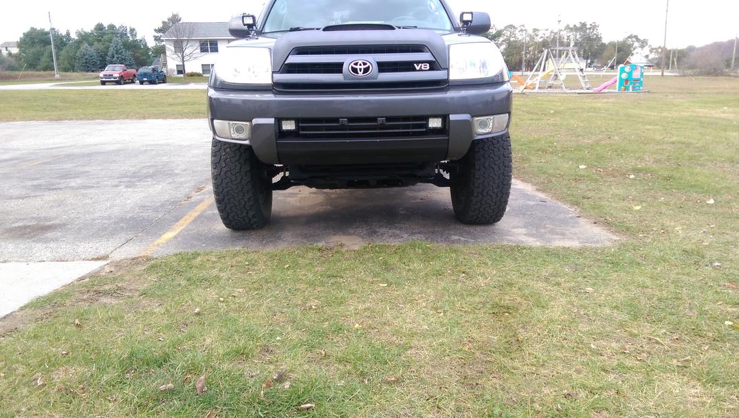

Center section gutted and trimmed.

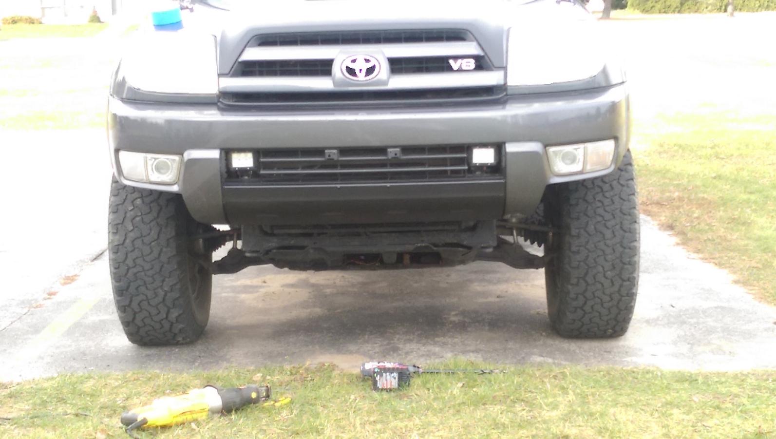

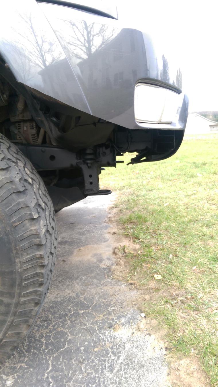

Cut high above the factory fog lights.
FAA52D97-D472-4AC6-919F-FD0071995285_zpsdvxtau1y.jpg~original
0EBF97E9-3288-4FBB-BA46-76CAAA8900AB_zps1zlmgk2h.jpg~original

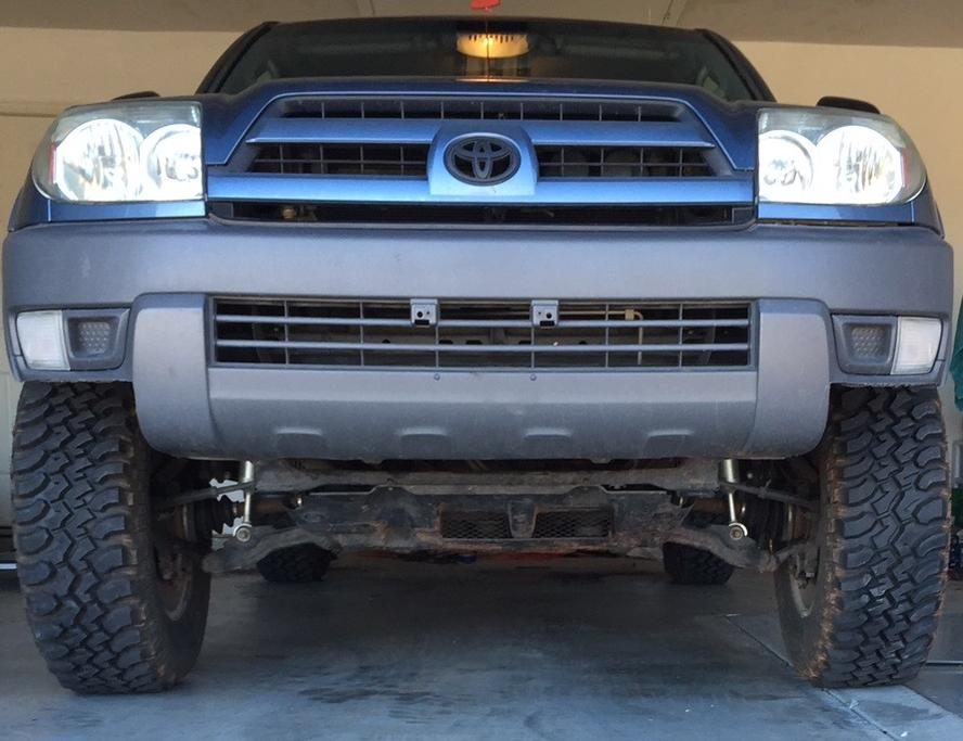

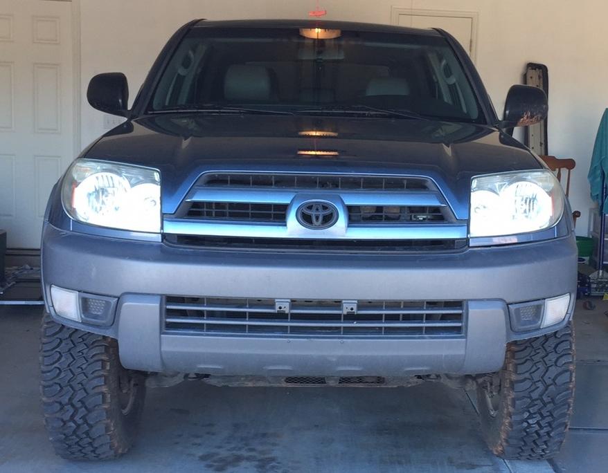

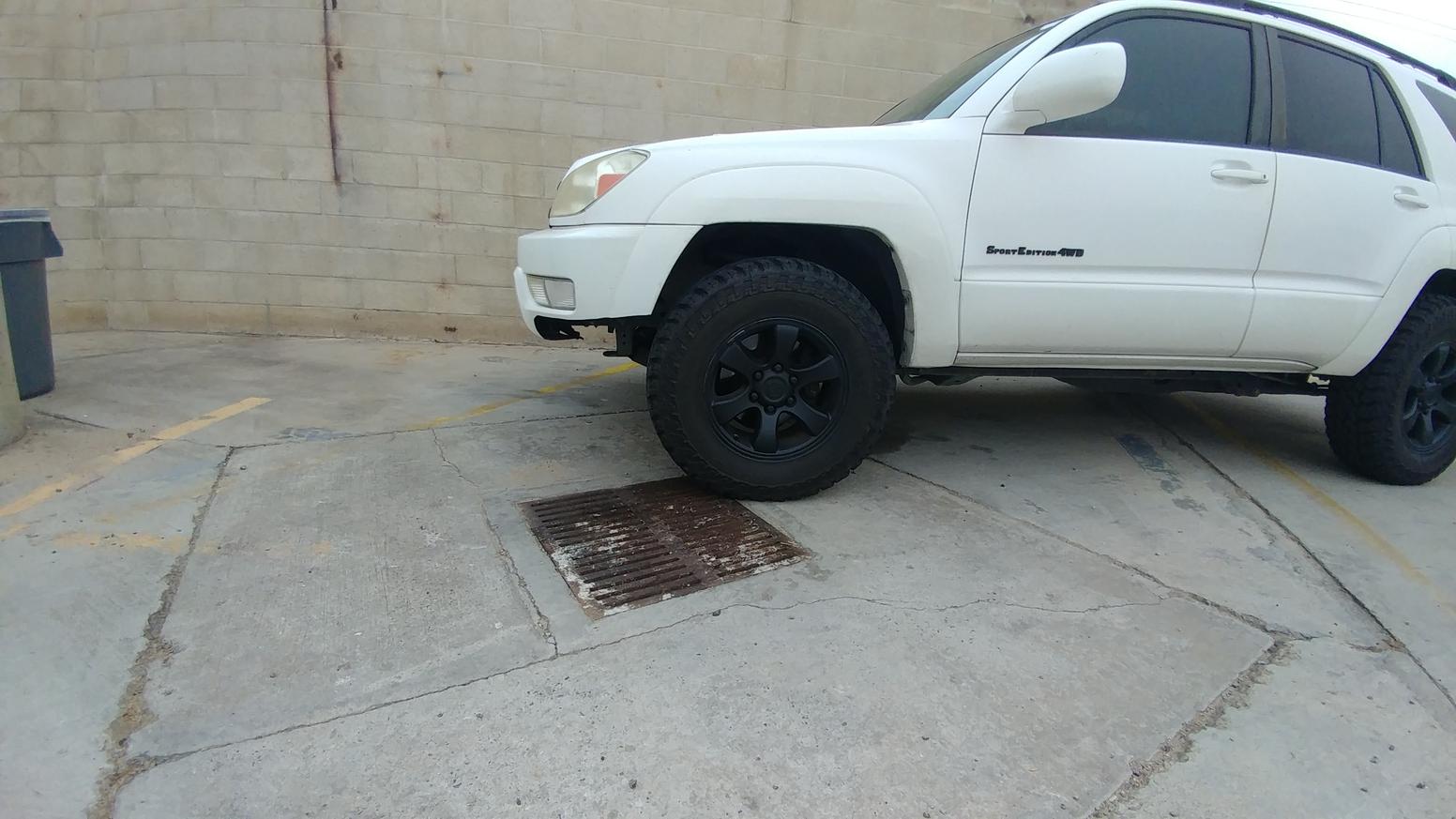

These are trimmed right below the fog lights. I suppose you could do this without the additional skid.
bumper.jpg~original
bumper2.jpg~original

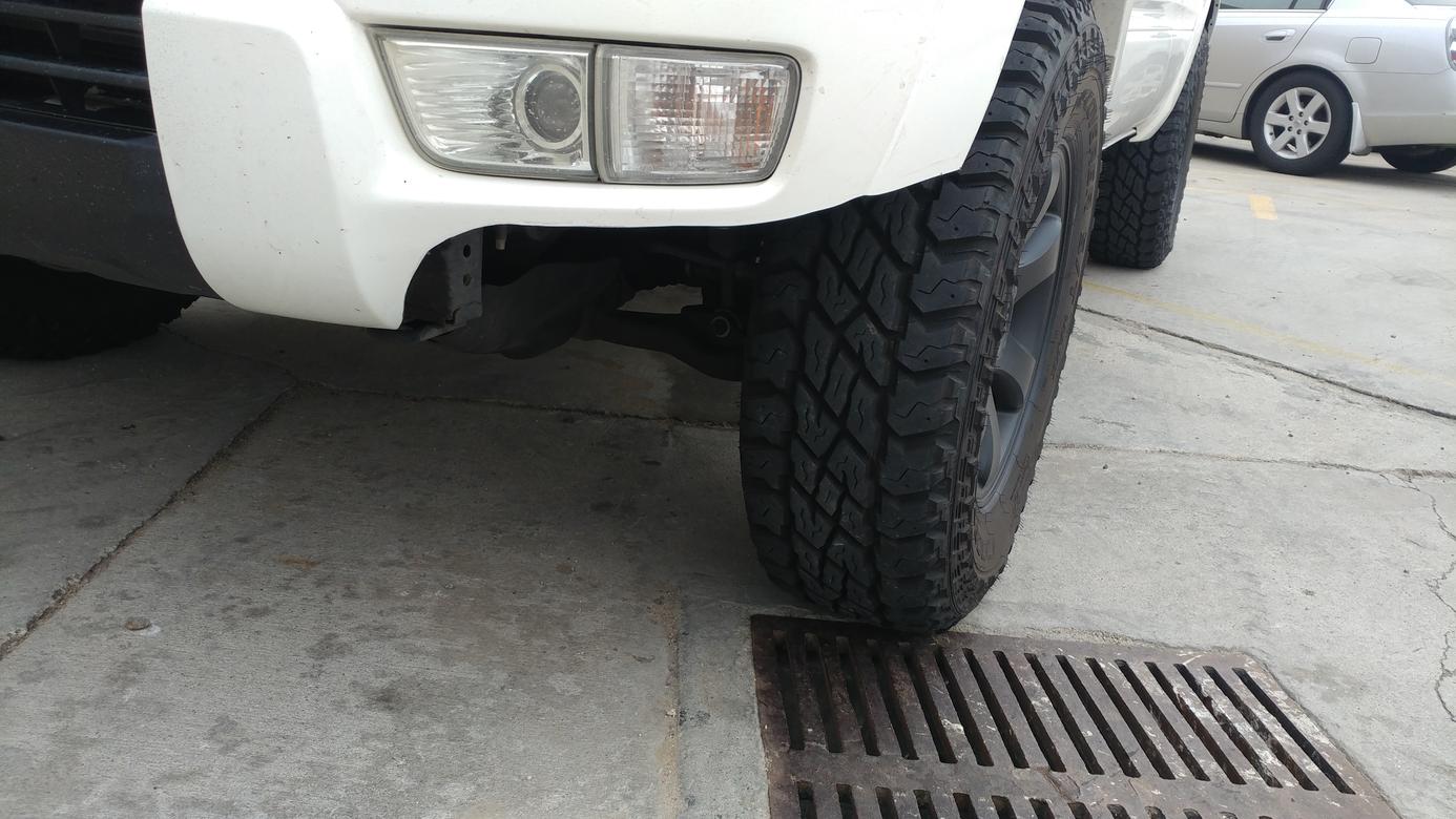

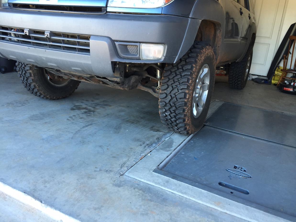

Trimmed the sides and below the fog lights to give me some more clearance. So far I haven't had any issue's with it and it greatly helps me get a tire up on rocks and such without hitting the bumper cover.

Want more info on the first pic with the center section gutted and trimmed! Does that belong to someone here??
Props to t-man for this budget bumper mod

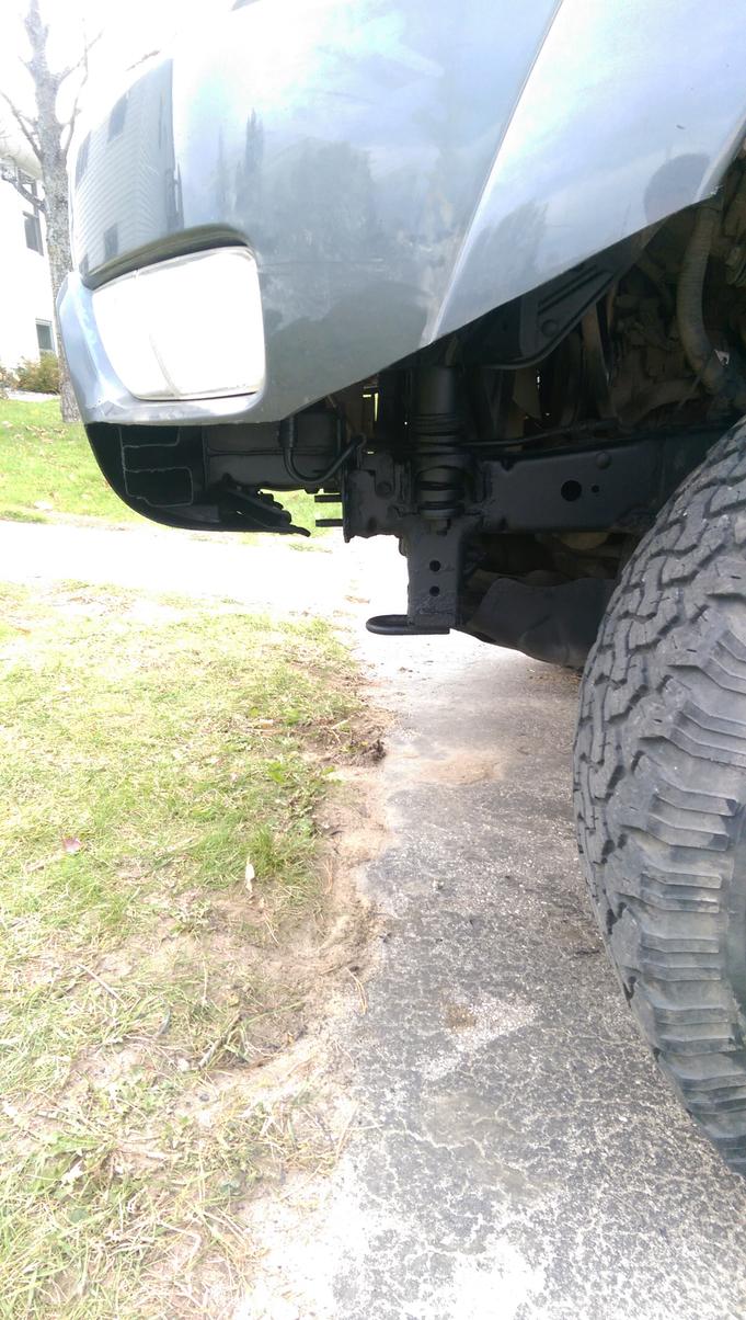

Took about an hour with a dremmel and cutting wheel. Safety glasses is a must.
