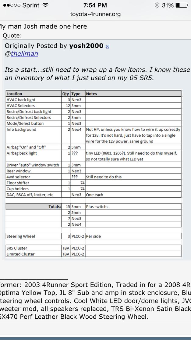

this is a master LED swap thread. no thrills, no chat, just the down and dirty qtys required for all years and trims for the 4th gen 4runner. my goal of this thread is to have all the info by many compiled into one single post so newbs dont have to sort through over 1,100 posts to find an answer! Some pics are my own, others i have taken from the other LED thread and the intarwebz.
if you have info/pics that are not shown and you would like them included, shoot them over to me and i'll add them to this first post to keep it all clean. hopefully this will be a great resource for many for years to come!
First off, below is a list of required LEDs for each item i know of (confirmed on my SR5, limited guys add or correct me as required):

Second, here are links for the LEDs:
Lighthouseleds
PLCC-2 (cluster): PLCC-2 / 1210 / 3528 SMD LED
3mm (HVAC indicators, driver "auto"): 3mm Round Top LED Ultra Bright - All Colors Available!
5mm (airbag "on" and "of": 5mm Round Top LED Ultra Bright - All Colors Available!
1206 ("airbag" background): 1206 SMD LED - Ultra Bright - Available in All Colors!
superbrightleds
Neo bulbs (Neo3 is the 3mm, Neo4 is the 4mm : HVAC background and switches): NEOx LED Bulb - High Power Instrument Panel LED | Super Bright LEDs . Do note, you must do the 12v mod for the Neo4 bulbs to work in the info display area if you run these SMD LEDs.
74 (cupholders, floor shifter, glovebox?): https://www.superbrightleds.com/mor...b-3-smd-led-miniature-wedge-retrofit-car/228/
Another source for neo bulbs. The non SMD LEDs should work in the info display area without having to do the 12v mod there.
Neo Wedge

Good stuff man, can't wait for the SR5! Are you going to do the HVAC cluster as well? I know there were a few different methods in the main LED thread about reverse polarity for the DIC screen too.
this is awesome, thanks for the write up. only thing I wanna ask, I'm not sure which LEDS you used for what?

For sure, that would be great. I might even have some of yours saved pending to add, but whatever you have would be appreciated. Just email me at the address in the dirt post.

i posted a breakdown in the larger LED swap thread. you can search for that if you need it now. I will try to update this thread with that info so its readily available.
note, i think i may have had one error, the 4wd dial uses a NEO4, confirmed. cant remember exactly, but i believe i may have listed that as a NEO3?
Any idea what page it's on? That thread is 91 pages long now..... talk about info overload...
