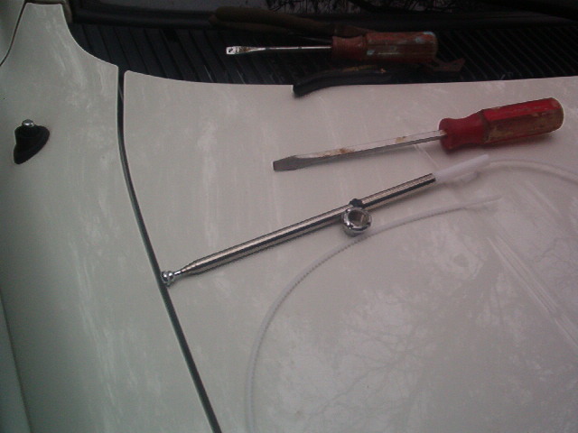

I finally got around to fixing the antenna. I bought a replacement at the local Toyota dealer. It was $48. The peson at the dealer told me what to do.
1.) Unscrew the retaining nut at the top of the antenna, I used a big screw driver to do this.
2.) Then with some help, turn on the radio and grab the loose antenna and pull it out, be sure to notice which way the teeth are that grab the motor.
3.) Grease the new nylon strand of teeth.
4.) Install the new antenna, first put in the nylon strand of teeth till it hits the motor, be sure to align the teeth the way they were.
5.) Have your friend turn off the radio, the nylon strand should engage, guide the antenna in the hole when the strand retracts. (Note: The new atenna was installed retracted.)
6.) Install and screw the retaining bolt.
7.) Turn on the radio, to see if it works. I had to turn it on and off a few times for it to fully retract and extent.
The is what the parts person told me what to do. I did not remove the motor, heck I basically did very little. Took less than 5 minutes. I will let you know how it holds up.
Basically, the teeth in the old antenna just strip off. I have a picture of the new antenna, retaining bolt and a screw driver that I used. Thanks for the help.
