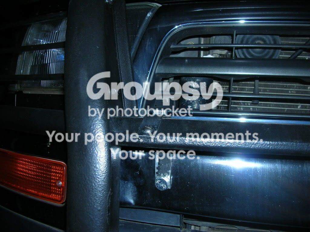

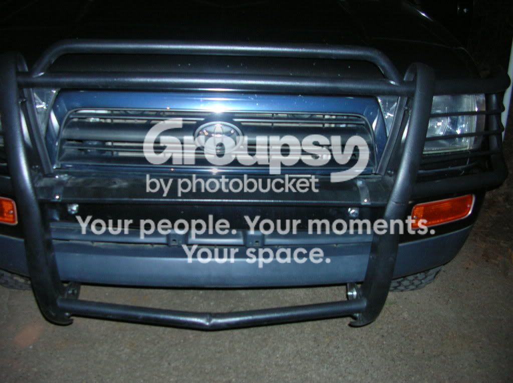

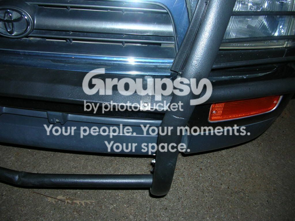

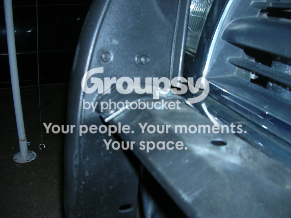

i'm happy to share i may have solved all of our problems, it only took about an hour.
DSCN3916.jpg~original
DSCN3917.jpg~original
DSCN3918.jpg~original
DSCN3919.jpg~original
i got a package of 4 (only used 2) 4 inch 90 degree L brackets. i had like 4 of the short thick (1/2 inch diameter) bolts l had left over from my grill guard. i spaced each bracket about 2 inches from the side bars of the grill guard. i used a 1/2 bit to drill a hole on each side of the cross bar to mount a bracket, and the same size hole on the bumper in the same place the the bracket already had holes fashioned. i made a mark on the bracket where it hung over the top of the cross bar, put it in a vice and bent it accordingly, then used the 1/2 inch bit to make the holes on the bracket bigger then just bolted them down. it works amazingly well, no shaking at all.
