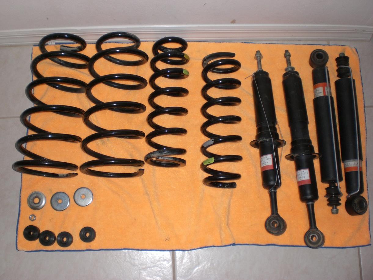

Also, can you fellas point out in the photos which parts go to which (front/rear), and do I happen to be missing anything?

Ok.. first picture.. left two coils are for the rear. Right two coils are for the front. On to the shocks.. left two front, right two rear.
You should probably take it to a shop if you're not to sure about it as you can damage other components in the process if you're not too careful or skillful. The rear is much easier than the front. You have to watch the brake lines though.. too much extension on the axle and you'll break those lines. The fronts are more involved.
You will need a spring compressor as well to install the coils on the front shocks.
Does your Limited have X-REAS? If so and you want to save the X-REAS for returning back to stock, you will need to disconnect hydraulic lines from the shocks at the correct locations. They are not to be disconnected at the shock.

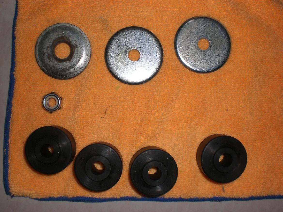

Had two more small questions before I decided to proceed:
What are those 3 washers and 4 rubber objects used for, and I was reading Run'n'Gun's write-up, and it seems like he was able to remove and replace the rear springs without a compressor. Is that correct?

the small parts in the pic look like sway bar end link bushings ( not 100% sure) i just did an fj swap and i didnt have those part.
