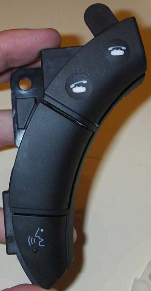

Here is an attempt to post a picture of the part from the '05 Landcruiser. PN# in my pervious post.
Note that the grey ("stone?" = B0) color from the landcruiser exactly matches the 4Runner. (not true with some other models)

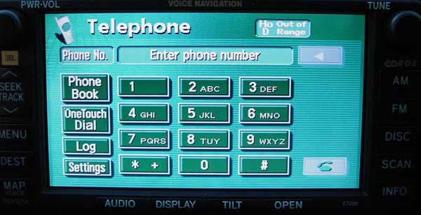

... and look what happens when I press the bluetooth buttons! :)
I know others have mentioned that BT support is in our nav software.
Soes ANYONE know what model # is on the front of the Navigation systems in the 2005 Landcruisers? My 2005 4Runner is E7005.
So is the BT hardware a module that plugs in on the landcruiser or built into the nav unit?

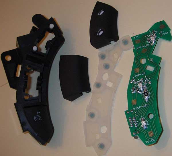

Here's the disassembled switch assembly (see part # in prior post)
Switches:
1 - rocker bluetooth on/off hook
2 - blank. However 2 switches exist under here, corresponding to "disp-on" and "disp-off" on the board
3 - voice single button. pressing this makes it announce "voice recognition session finished" (I have no mic)
There's also contacts for switch "acc". Doesn't do anything.
If I can't figure how to add a bluetooth module controlled by this nav system (unlikely unless the landcruiser uses the E7005 too) then I'm going to use the switches as follows to control the mute on my built-in radar detector and the new motorola bluetooth kit.
I'll cut the circuit board traces to each switch and wire into them directly, then use them to switch the buttons of the 4 channel keychain remote control
http://www.smarthome.com/7446WA.html
This will let me get 6 channels of programmable relays at the receiver somewhere outside the steering wheel. I could have probably encoded the buttons and intercepted the commands before they went to the nav system but didn't want to mess with it.
This part comes with GREEN LEDs, so I need some orange LED surface mount. (voltage drop across them measures 2.0 volts)

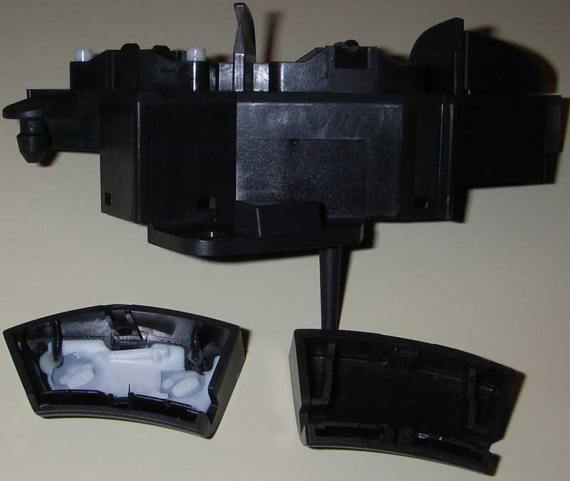

Here are two of the buttons removed.
The left one is the bluetooth rocker. When it rocks, it pushes down on one of the two white pins, which press a membrane switch.
The middle blank has plastic channels in it to keep it from rocking, but notice it still has the center pivot (and the membrane switches underneath!). I'm pretty sure I can Dremel-remove parts of it so it can rock one or both directions. I bought #10 plactic screws from Home Depot to serve as pins (need a little sanding and grease to glide)
So this could give you 4 additional switches plus the voice one. (if you didn't want the BT-marked buttons, maybe you could buy the '04 model without the BT buttons? I don't know if it has switches under both blanks...)
