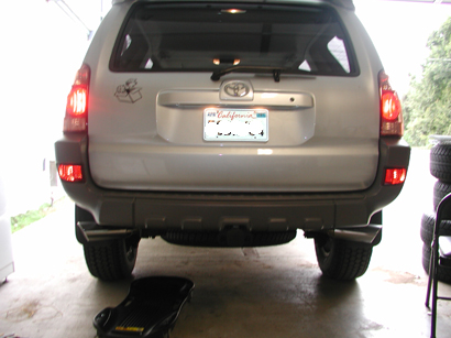

1. <B>Remove the lenses.</B>
Each rear red foglight lens housing is held in place with a single 10MM nut. You'll need to crawl under the rear and look up into the bumper to see it. Loosen it with a 10MM socket and you can remove it by hand. Pull the lens out of the bumper.
2. <B>Make a hole for the bulb sockets. </B>
Place light housing on a soft scratch free surface such as a towel.
You'll see that the spot where a bulb would normally go is sealed. And there's a little hex shaped nub in the center. Using a pair of pliers, break off the nub. Then drill a small pilot hole in the center of where the opening will be. Use the small hole cutter to CAREFULLY drill out the hole. GO SLOW! I ended up going just over half way and then broke out the hole carefully with a pair of needle nose pliers to avoid doing any damage. Check the opening for fitment of the bulb and socket and sand or file the edges as needed.

8. <B>Reinstall the assembled lights.</B>
Carefully tuck the wires into the open hole in the bumper and reinsert the lamp housings. Reach up and hand tighten the 10MM nuts first. Then tighten with socket wrench. You don't want them rattling loose and falling off or the lenses will fall off too.

10. <B>Connect the wiring.</B>
At the trailer connecter there's a bunch of wires that lead up to it. Go back a little further where the wires join from the tail lights to the connector. Using crimp connectors, attach the marked ground wire and the leads as follows to the wires leading to the trailer connector:
<BR>
<B><U>NOTE:</U></B> Toyota does not use the same colors as a standard 7 pin connector. <B><I>(To help you find the wires needed, there's a cluster of brown, red, blue and yellow that go off one plug underneath near the trailer connector -- you may need to unwrap some of the tape to see the colored wires)</B></I>
<UL>
<LI>Ground wires from each light go to the <B><U>THICK WHITE WIRE W/ BLACK STRIPE</U></B> <I><B>(ground)</B></I> leading to the connector
<LI>One lead of RIGHT bulb/lens goes to <B><U>BROWN</U></B> <B><I>(right turn/stop)</I></B> hot wire leading to the connector
<LI>One lead of LEFT bulb/lens lead goes to <B><U>RED</U></B> <B><I>(left turn/stop)</I></B> hot wire leading to the connector
<LI>Remaing leads go to the <B><U>THIN GREEN W/ BLACK STRIPE</U></B> wire <B><I>(tail lights)</I></B> leading to the connector
</UL>
<B><U>NOTE:</U></B>
<I>If you do not want auxillary taillights, then do not connect the grn/blk wire) I did, because I have tailshade covers installed and the tail light intensity is slightly reduced -- the extra lights in the rear can be useful in inclement weather or if one of the stock taillights burn out.</I>
11. <B>Test the lights</B>
Have someone hit the brakes, use turn signals, turn on hazards and headlights/taillights to ensure bulbs work properly. Left and right bulbs should work with associated amber turn signals. Both lenses light up when parking/headlights are turned on. Both lenses light up intensely when brakes are applied. Both lenses flash brightly when hazard lights are activated along with amber signals. (ie; two flashing amber and two flashing red all illuminate at the same time.
