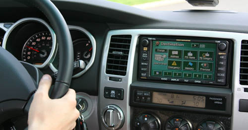

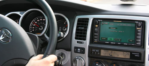

Here are a few pictures to prove that this mod actually works. Thanks to my brother for taking these pics for me!
Here the destination menu is still unlocked while driving. I don't want to promote that the driver should be doing this while driving though because it isn't safe!
