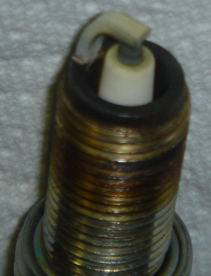

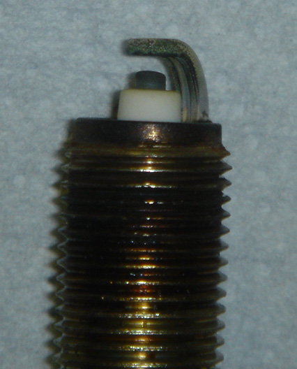

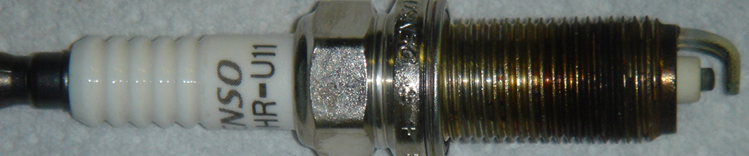

This actually relates back to an earlier thread I posted about 2 weeks ago:LINK . Well, per BOAZ's suggestion, I pulled a plug on my 1GR-FE V6 to verify if the stealership actually replaced the sparkplugs as the invoice didn't list any sparkplug parts. I doubt they even changed the diffs/transfer case fluids as I specifically instructed them to do so. Diffs/transfer fluids need not be replaced with the 30k mile service, but the sparkplug replacement is definitely required. So I called the service dept today and spoke the the same service manager who wrote the work order form for me and I asked him why weren't the sparkplugs changed as it is clearly noted in the maintainance guide. I told him mine had the 1GR-FE and it doesn't use the iridium sparkplugs as in the V8s.
At first, he tried to play it off and said that he's not sure why the tech didn't do it. He puts me on hold, then he said they could change the plugs if I bring it in, but they'll have to charge me for it. I told him that was a load of B.S.! I had called the service dept that morning before I brought it in to verify the pricing and all the service items to be performed for that price. The rep told me $357 for sparkplugs, tranny/diffs/transfer case fluids, engine air filter, driveshaft lube, etc. When I had the service manager write up the work order, I specified actually what I wanted done and he said okay and the price was still $357. After the work was done and I received a copy of the invoice, I asked the same service manager again if all the service I requested was done as the invoice wasn't very detailed and didn't show any charge for sparkplug parts or quarts of diff/transfer case fluids. He replied yes, they were done accordingly. After explaining this to him on the phone, he agreed to have me bring it in for them to replace the sparkplugs free of charge. I was somewhat satified, but I feel that they were trying to pull a quick one over me. How can the stealership perform a 30k service without changing the sparkplugs as needed and then later on say that it wasn't part of the 30k service quoted at $357. Then why the hell are they advertising $357 for the 30k service which specifically listed sparkplug replacement?

Here's a few pics of the sparkplug I pulled. Bare with me as I haven't figured out how to attach multiple pics at the same time. Any tips?

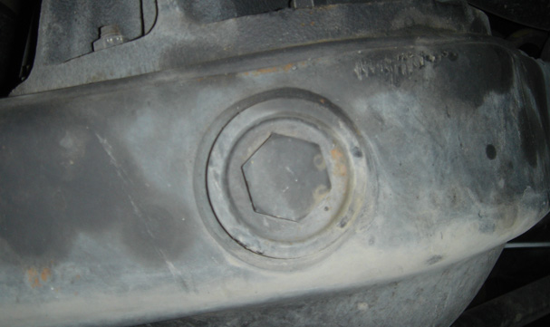

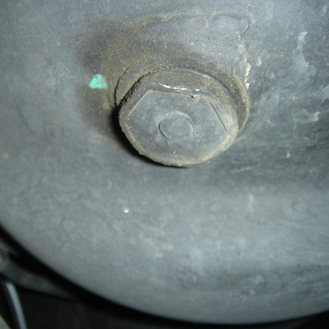

Here's a few pics of the rear diff. It doesn't look like any fluid was changed at all.

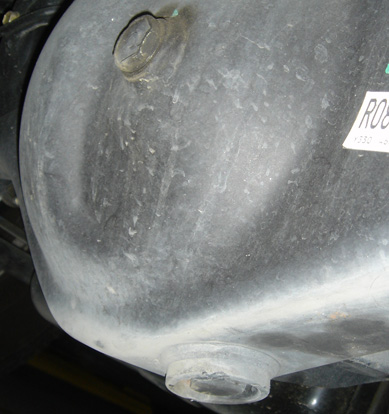

another rear diff pic. no marks to indicate that it has been drained.
By looking at the picture I'm 100% sure they did not change anything!! I would have been sooo F$%ing piss! I would take even action possible toward the dealer!Call your local news station, toyota corp.,BBB! demean your money back!!
cancel the credit card charge and tell them why and tell them you can email them the pics:)
or demand the job be done correct or drive the truck through the showroom:D
SO they charged you the $357?
Well you can either cancel the charge on your card or have them do ti with you atching this time and give you a credit for soemthing since they didn't do their job, tried to cheat you and also inconvinienced you.
WOW, you got them by the short hair with though pic's and the invoice. Don't have your car serviced for these items until you get this resolved. I would call and talk with the regional service rep for Toyota. Send him a copy of the invoice and these pictures with the details of what happened. Tell him if he doesn't want to get your money back plus have the service done for free for all of the BS you have had to go through you will take this to the BBB and the local media as well as any other media you can get on the story. If he doesn't help you then follow through along with calling the GM of the dealership. Then take them to your local small claims court.

Man, this dilema has been on my mind all weekend and every time I think about it, I get even more pissed off at the stealership. At first I was content with bringing my 4R back to have them replace the sparkplugs, but now that I think about it, they really dropped the ball!!! How the hell can they say that they "performed" the 30k mile service on a 4.0L V6 (1GR-FE) WITHOUT replacing the non-iridium sparkplugs? That's like ordering a meatball sandwich and not getting any meatballs. WTF are they thinking! So they FORGOT to replace the sparkplugs which was REQUIRED at 30k miles, but decided to replace the ENGINE COOLANT which didn't need to be change UNTIL 100k miles! :mad: Why the hell did they think that the SUPER LONG LIFE COOLANT needs to be changed at the 30k mark? Had I not pulled a plug to verify if they were replaced, I would've driven with them until 60k miles. Talk about decreased performance and fuel economy for the next 30k miles! BTW, the plugs need to be changed every 30k miles as "REQUIRED UNDER THE TERMS OF THE EMISSION CONTROL WARRANTY" that is clearly noted in the Scheduled Maintainance Guide booklet.
