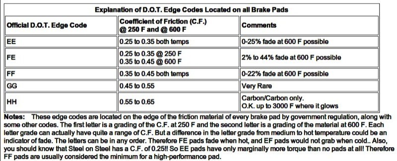

  1. Tires DO stop cars in that the tire friction footprint is all you've got
  2. Disk brakes stop the wheels where an E rating is steel on steel (yeah, rotors are usually "gray iron")
  3. IMHO, pads are pads are pads (where there are differences but you can't tell ahead of time)
  4. Whether a pad is ceramic or semi-metallic or NAO is more marketing than chemistry (IMHO)
  5. Certainly some dust more than others & some squeal more than others & some wear faster than others
  6. But you can't tell that just from what is written on the pads
  7. Besides, it's my opinion you almost can't get a bad pad if you follow logic
  8. The only thing you can tell for sure is the cold/hot friction rating of the pads
  9. Lots of brake pads have E friction ratings but most are F or G & even H rated
  10. Every pad has the cold/hot friction rating stamped on the product (by USA law)
  11. So I buy pads by their friction ratings and not much else (shoot me for being factual)

People don't believe steel on steel is an "E" rated friction coefficient for brake pads so take a look at this chart before you say otherwise.
