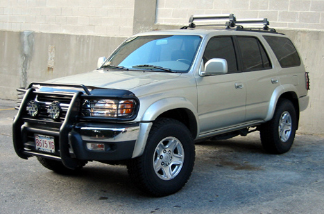

Man, that's a nice lookin' rig, wabbit - the new fogs look awesome.
A bit of a tangent here, but did you install that Thule rack on your factory rails? If so, was it relatively easy? I installed my snowboard carrier to my factory rack with the "fat-mouth" clamps they have available - as you can see in the picture below, it works, but they stick up really high and the setup doesn't feel as sturdy as it should be. Also, does the fairing get in the way of your sunroof?

NP on posting the pick, just need to wait for me to get it, then installing it.
Yep, I took the whole OEM roof rack off and had the rails powder coated and then just put the THULE load bars on them with the mounting hardware. I got it all at www.rackattack.com as they will spec out what you need for your vehicle. I got all the THULE stuff for $215, which was on sale for 15% off at the above mentioned site.
I don't have a sunroof but I know a guy who does and his fairing doesn't interfere with his sunroof.
