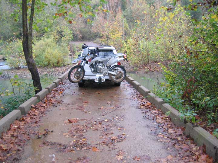

I have been more than pleased with my Donahoe Coil-Over front suspension, which is set at 3" of lift. This allows me to crawl over every rock I want to without hitting anything under my 4th gen 4Runner, without affecting my on-road performance or ride comfort.
In back I still have the NE coil spring spacers, and some huge shocks from Mike's Off-Road.
When carrying my KTM LC4 motorcycle with a hitch jack, at night, the rear sags a bit. Truckers were all pissed with me when driving at night.
Decision: 1) Wait for Donahoe to come out with a 2" or maybe 3" longer coil spring, in the first quarter of 2006. 2) Install the longer Downey springs, which are known to sag. or, 3) Get some of the airbags to fit inside the stock springs to pressurize when I carry heavy loads.
I would prefer to get longer springs, that will last without sagging, and get the airbags. I hope to get all this taken care of before Christmas.

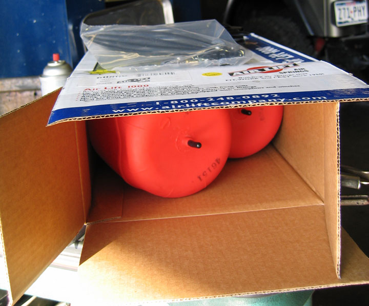

Mike's Off Road installed the kit today.
Here is the box and uninstalled air bags.

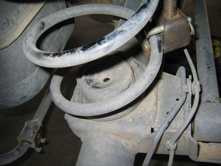

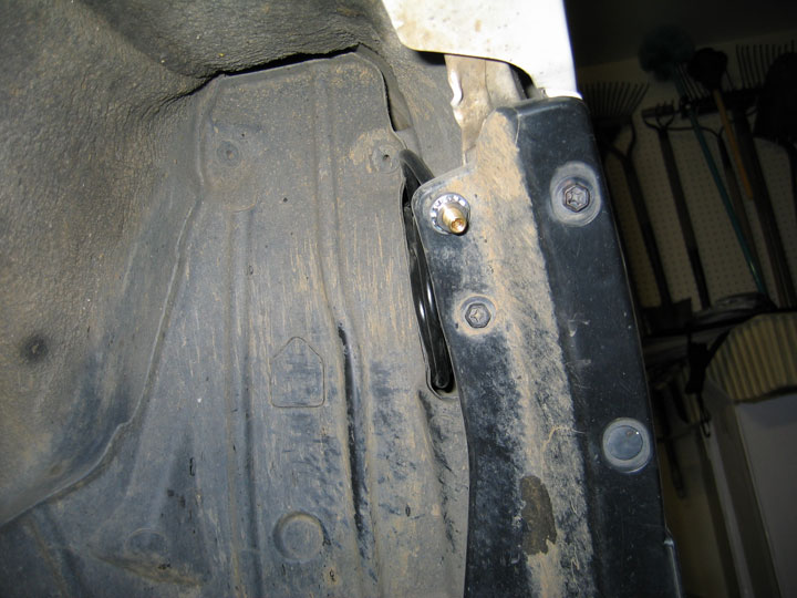

There is a hole at the bottom of the spring base. The air hose goes over the axle, up thru the hole, and connects to the bag.

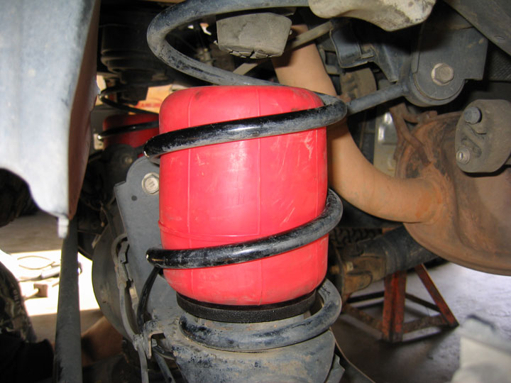

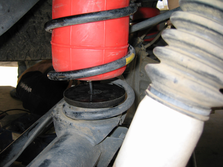

Since I already have the 3" spacer lift, I left the bump stop in place.

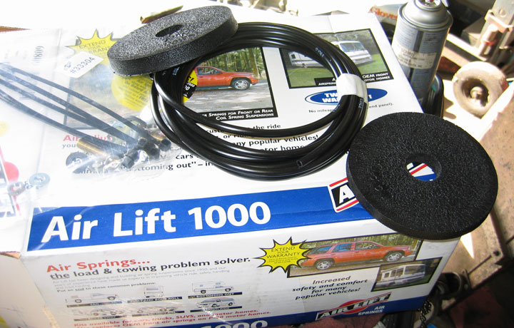

The air hoses were joined into one valve inside the wheel well mud flap. We left a lot of extra hose incase I want to relocate the valve into the fuel door. However, the soft rubber surround the fuel cap didn't seem like a good choice for now.

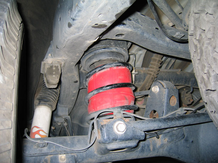

Here is how the bag looks with the weight on it. I have 10 lbs of pressure right now. I have about 50 miles with some off-roading, with the bags in place.
