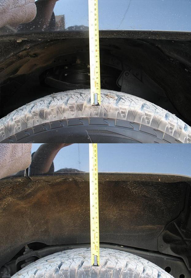

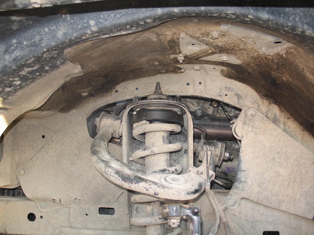

I measured gaps between wheels and fenders before installation:
Front
Final lift measurements?
Thanks for sharing this with us. I have been contemplating on getting a set of lifts my self.
I could do the math, but I would rather see a picture of the final height just like the one you initially took before the lifts by lacing the measuring tape up to it.
Thanks.
Dax
Re: Final lift measurements?
Thanks.
Dax
Oops. Sorry, I forgot to place those pictures. I'll look for them at my home computer tonight and will post them. Thanks for reminding. I was so impressed of the look after lifting, that forgot to post some images.

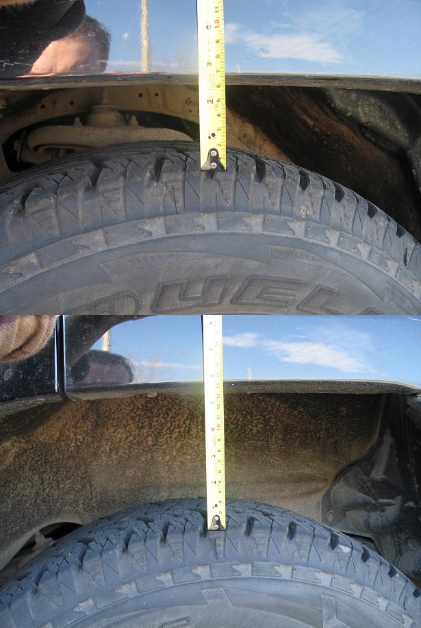

Here are missing pictures:
Pics
Thanks for posting the pics, I now have a better understading.
As soon as I can rationalize this MOD to my boss (wife) and I get the go ahead I'll jump on it.
Later Dudes
Dax
