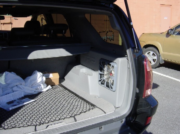

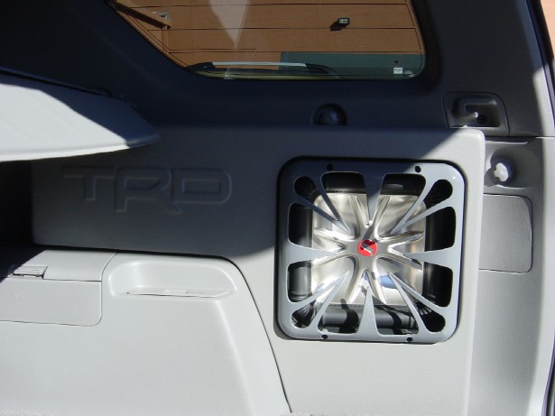

I was very impressed the work they did at the shop. They took out the JBL amp and sub (which was all in one piece), and built this box out of 3/4" MDF. The box was very intricate with many turns and corners. They built the box so that it would fit into the space left behind once the JBL was removed. They also Dynamatted the quarterpanel behind the box to reduce vibration. The box is about .80 cubic feet. That is a dual 4ohm voice coil L5 Kicker sub. They covered the box in the same color and textured vinyl that is in the rear of my truck, so it doesn't get any more stock looking than that! I also like the touch that the TRD adds. Very cool. I've got the Alpine 350 under the driver's seat powering it...350 watts at 2ohms. As for the rest of the system, I installed the Alpine HU, 9851 which is really easy to use. I've also installed a Sirius tuner that the Alpine controls, along with the PAC-SWIX to keep my steering wheel controls active. I replaced the front 6 x 9's with 6.5 Infinity reference components, and the rear door speakers with Infinity 2ways. They are powered by an Ample Audio Exonic ampy, putting out 60 x 4 to those speakers. The system sounds very clear and accurate. There is no vibration at all. I am still going to dynmat the whole thing (hopefully that will help with the resonance of my Magnaflow exhaust).

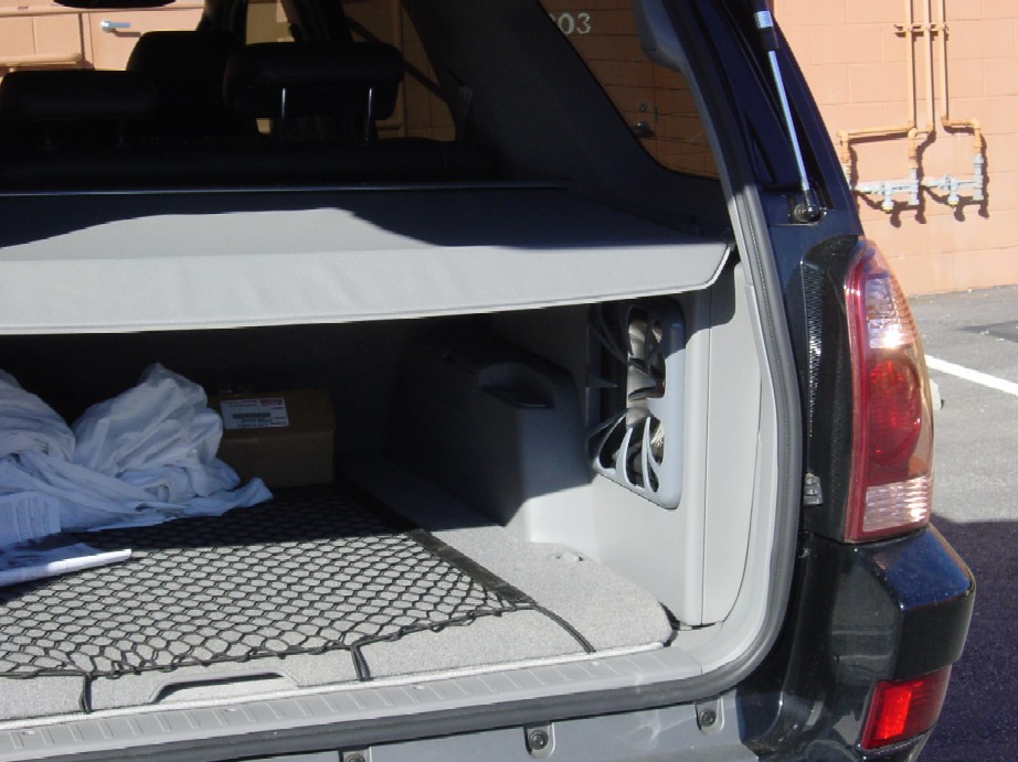

They made it so that the double decker cargo system works, as does the tonneau cover.

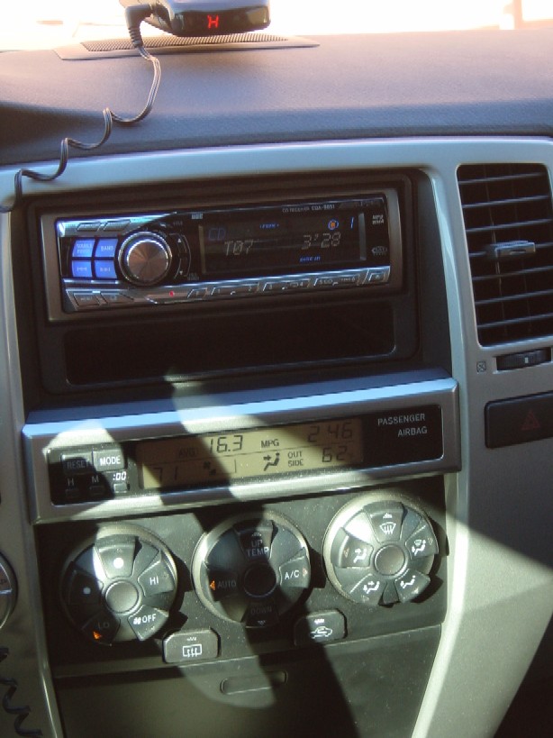

Very impressive install! I apologize in advance for my ignorance, but I couldn't help but notice in the pic of your head unit I noticed that on the display of your climate control that it also displays your MPG.....is this only available on sport ed. and limiteds? I don't think my SR5 has that option. If so, how do I get it to display? Thanks!
Blaine
I just hit the "mode" button on the left of that display to toggle through mpg, avg mph, and miles to empty. I'm not sure if all models have this or not.

Do you know how deep the box is for clearance of the sub driver? Would be great if they can make a 12" round cutout as opposed to square.
The installer designed the box specifically for my speaker. The L5 speaker is a very meaty speaker, with a very large magnet, and thick construction. If my driver could fit, I would imagine any other driver could fit, depth wise.
