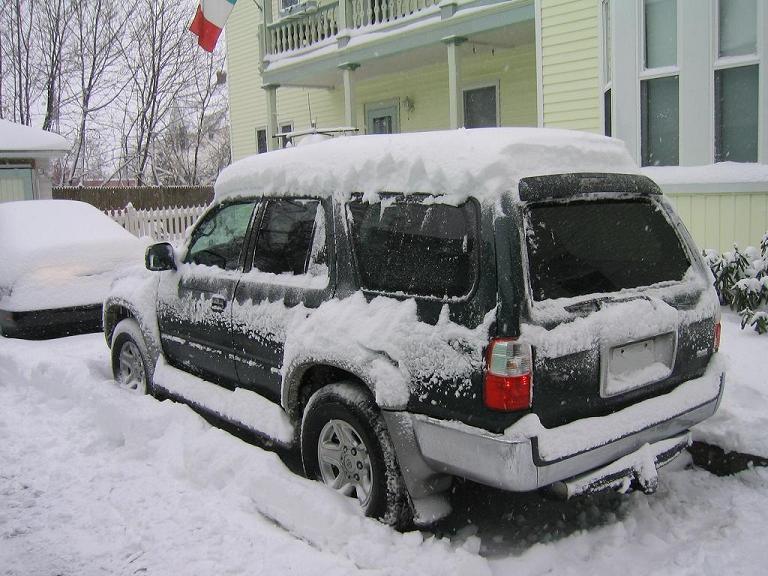

Here's a pic of the snow in New Hampshire.

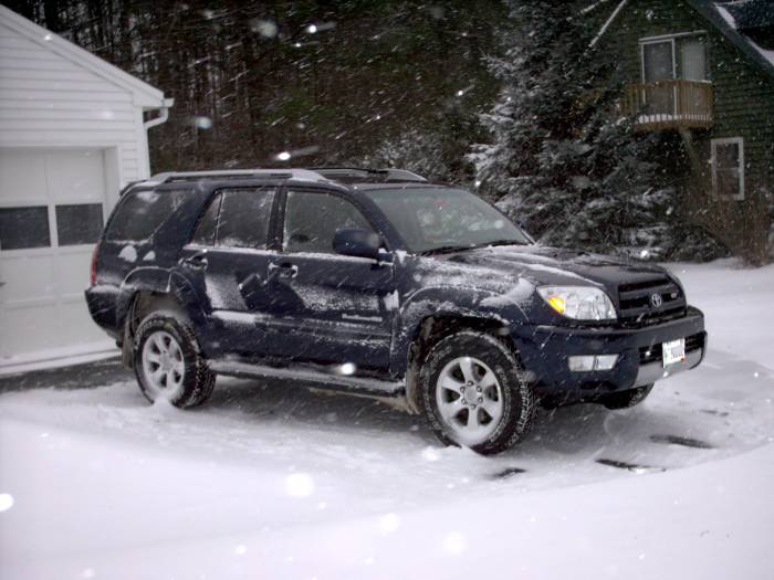

The snow wasnt that bad here. Lots of snow drifts and slippery roads.

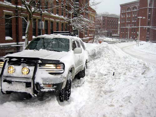

You can't really tell from the picture, but there are actually 6-7 cars lined up behind me that are completely buried.

Iman74 said:
PIAA's? Nice!!!
Yep. I'm seriously considering a set of fogs too though. We went snowboarding Saturday and I need more light for whiteout conditions - I tested the driving lights and they were just not made for that kind of use. It was like blinding sunlight! :cool:
