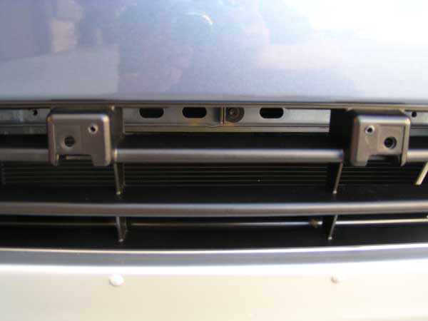

CA requires plates in front and the dealer drilled the holes on mine. Here's a picture of the holes. I'm sure there's a mark or dimple of some kind to let you know where to drill. It's the two smaller holes toward the center of the car.
