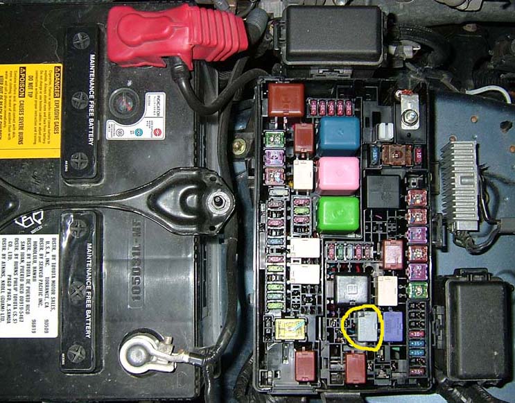

Check the relay circled in the picture below, labeled MG CLT on the underside of the relay box cover. If it's white with 90987-02022 stamped on the side, that's likely the problem.
Replace it with part number 90987-02028.
Freaking excellent information. Thank you guys!! It seems to work now, but I'll go ahead and treat it like the problem will come back.

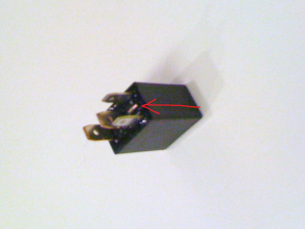

Check out this thread. Order the relay mentioned on page 6 from Digikey. I ordered 2. Less than $15 shipped. Arrived in less than a week. I broke off the center of 3 pins. It works perfect!!! Sure beats $1100!!! You can also try the tap on a hard surface trick. Mine lasted over 10 months longer that way. If it works it is the relay only. If it doesn't still replace the relay. You will only be out less than $10.
http://www.toyota-4runner.org/problems-warranty-issues/17634-c-light-flashing-6.html
See pic with pin broken off.
