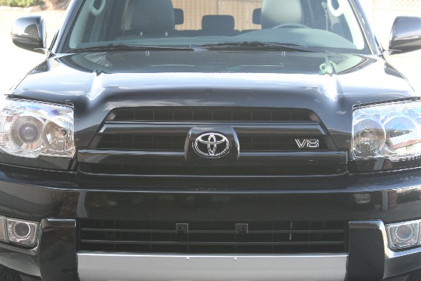

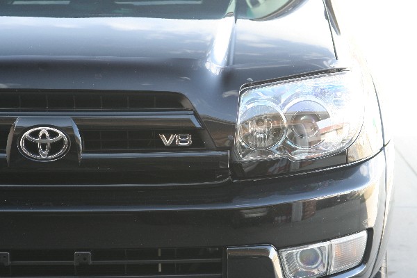

I have a 2003 4runner Limited and have ordered the following parts to convert my blacked-out halogen headlights to a 2006 projector based headlight.
When anyone is planning on this AMAZING upgrade, you have two choices in terms of headlights. The SR5/Limited use a chrome (shiny) housing whereas the SE use a gunmetal colored housing. I have a black truck so therefore I opted for the SE headlights as I do like the color of it.

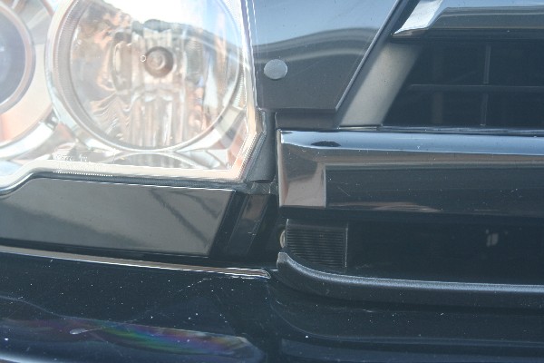

That looks like a nice cut off pattern just like HID projector. I have been thinking doing the mod ever since I saw mlopez61's install. How does the gap looks up close? Does the piece under the housing come painted?

I see you hid the gap mostly with the canadian hood protector.:bash:
yea.. well.. I had it on my truck from day one so... :D
This set me back around $1300CDN including everything.
The bottom pieces come painted to whatever color you want.
