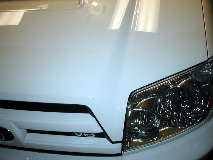

I have it installed now. I spent 3 hours with the install guy BSing while he did his job. $75 later and the three pieces I bought are there doing their job. Anyway, he said that he has been installing the 3M stuff for 4 years of so. He said that the clear stuff made by Avery does not last as long as the 3M product. That you can always lift it off anytime you don't want it anymore. I have looked at the 3M site carefully and see that they do NOT want their product installed over headlights though.
Anyway it is cold here (40s - that is cold for Dallas) so it will take a while for the clear film to cure. The installer said that I should keep an eye on the corners and edges for a week, that it takes time in the sun for the adhesive to fully cure. So far the slight fog under the film keeps getting clearer. Here is a photo from minutes after the install, and a drive home in a downpour.
