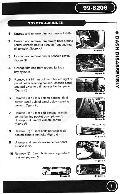

For those who has taken out there stereo to replace it with an aftermarket one. Could you tell me how to remove the center console/bezel. I do not want to send like 15 minutes trying to figure out how to remove it. I am going to be installing a new stereo this weekend. If there are any points that needs to be unscrewed, could you place a pic of where all the screws are. Thanks.
For the most part the console just pops out with 3 screws holding it down, hope this helps.
