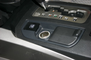

I've just purchased a 2005 T4R SR5 after driving my '93 4runner to 195K miles...my '05 has the "Ashtray Kit" in the center console, but, having read through the various threads here, I think I'd prefer more storage, and only need 1 power outlet for my cell phone. I can't, however, find a part number or description anywhere for the original console accessory box.

picture of the ashtray console insert.

I inquired about the original (pre-ashtray) insert with several vendors and have not been able to get a part number.
One vendor said "The ashtray kit is an add-on; there is nothing in the blank space if it is not added."
if anyone can help with a part number for the original powerpoint/accossory recepticle I'd be appreciative.
