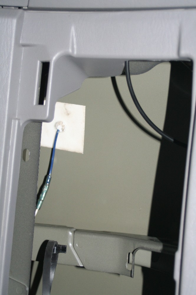

Ran the wire to the back along the frame rail and attached the rear coupler pad on the inside sheet metal behind the jack/tools:

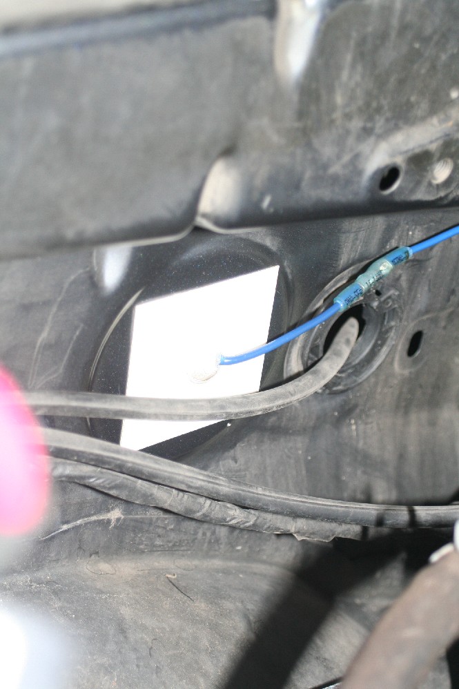

Attached the front coupler pad on the passenger side in the engine bay ahead of the firewall:

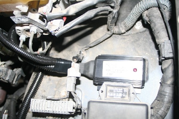

Mounted the control unit behind the fuse box. Cleaned up the wiring with wire loom and made the battery connections (may clean this up more by hiding the wiring more.)
I plan on running a long term test by mounting some professionally painted test panels (one grounded; the other insulated) just to see if there is any validity to what they claim.

Looks exactly what i see on Guam based Toyota vehicles. I tell ya that ocean air is jus killer on our cars. Let us know how it goes Kmv, thanks for being the guinea pig hehe :D
