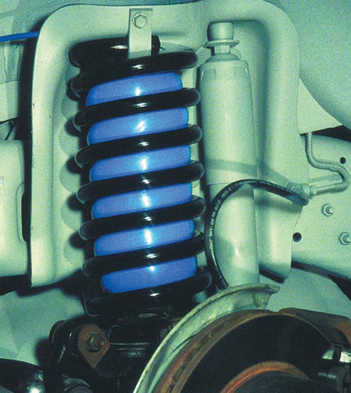

I used Air Lift air bags on my '98 4Runner to level the rig and was very pleased with them. They were cheap, installed easily and lasted the 5 years/75K miles I owned the truck with no problems. When not towing, they can be deflated to 5 psi and you won't know they're there.

I now own an '03 Limited 4WD V8. It has the rear air suspension, which is great - you simply drop the trailer on the hitch and the suspension adjusts itself for a level rig. I tow at about 70 mph, in 5th gear ("D") on level terrain. I averaged 14.5 mpg (calculated, not from the inaccurate trip computer) over the 5,000 miles I towed last season.
