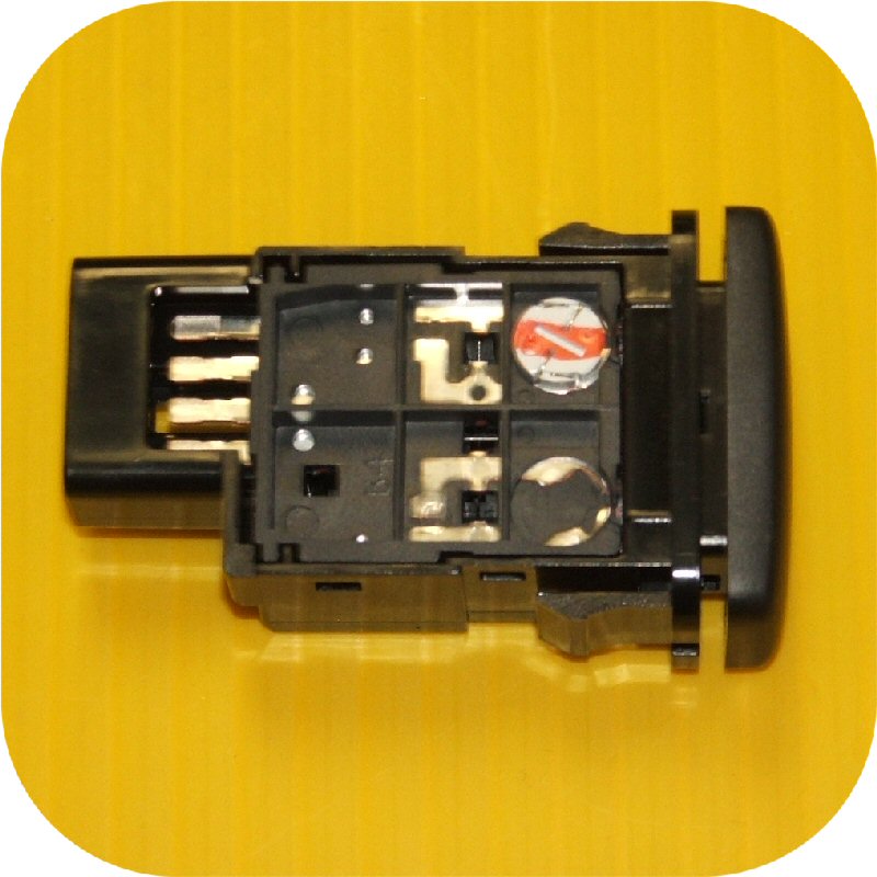

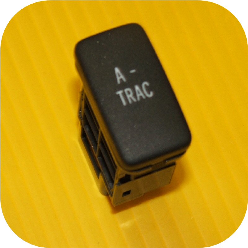

The factory switch would be nice, but i think it would be harder to install. I did an ebay search and found one for the 07 FJ, but, as expected, it was one that just plugs into a harness, meaning simply splicing the wires and adding a toggle in the circut would be kind of out of the question. i think you would also need the harness. Im not sure on any of that though, just my guess looking at the pic. (plus its expensive for a button... like 60 bucks vs. a $3 toggle switch.

That is an Atrac switch , I would not want to disable that , just VSC. The atrac is where you get traction from. The VSC is what cuts out the power that I dont like .
What model has the atrac button on/off switch ? The FJ ? Why would want the atrac off ?
Would the VSC switch from the lexus work & look factory ? Never saw one......
Yea i know thats the A-TRAC but i thought you could maybe use it as a VSC cancel button... my bad... im probably just going to use a toggle when i do this.
