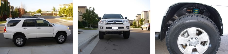

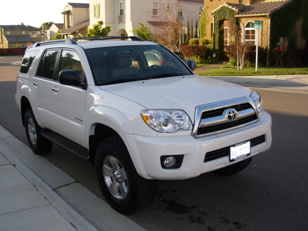

Tires on lifted 4Runner
You are correct. The tires are BF Goodrich A/Ts
285/70 R17. They are great, but they do rub against the frame when turning hard, a problem that I need to fix. Still deciding the best way to do this.

I am surprised you did not have to do any trimming, removal of mud flaps etc. Everyone here seems to say 285/70 of any flavor require that, at least a little. Have you compressed your suspension all the way yet?
wheel spacers
You are right about mud flap trimming. When the suspension is not compressed, it just barely clears, but it will rub under compression. An easy fix that I will do once I solve the main problem of the wheel hitting the frame, is to use a strip of bent metal to hold the mud flaps farther away from the tire.
