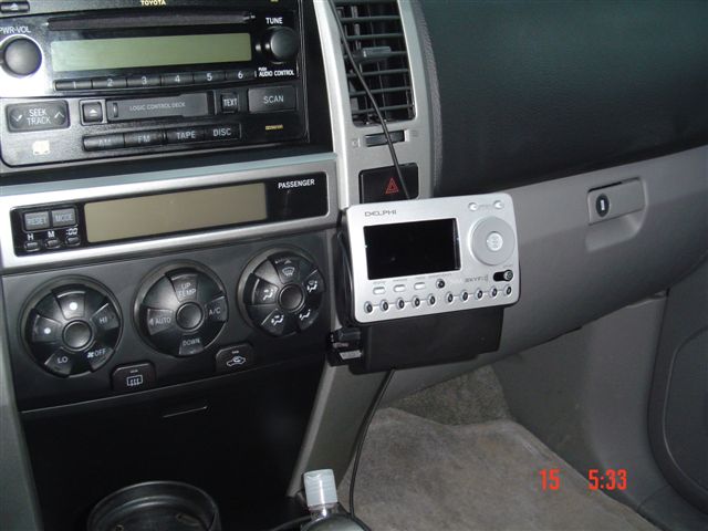

My wife had ours intalled, with the fm modulator, and swears that she can control the volume on the Delphi xm radio with the steering wheel controls.
I can't see exactly how the installation was accomplished becasue I'm not due to rotate out of Afghanistan until some time next month.
Once I find out how it was done, I will keep ya all posted.

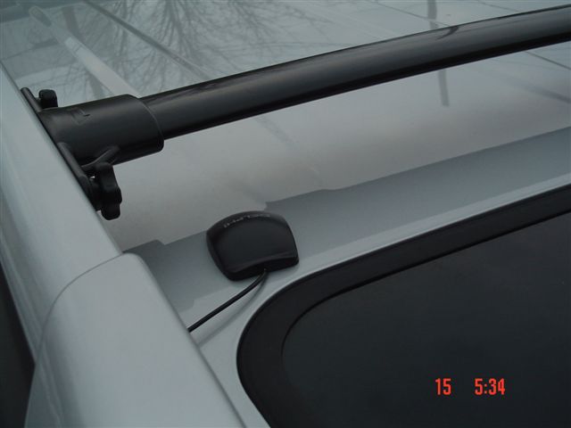

Antennae
Here is where the installer put the antennae.
on the previous picture, the wire that you can see next to the xm radio is from the radar detector.

Talk about perfect timing, I have been researching this for the past few days and tested someone that has that model (view pic above) in their car with the same setup. The reason she can control the volume because it works through the radio using station 87.5. Not knowing your wife or being in her car, I would assume she has that very same setup.

I do think that is how she is able to control the volume.
I/We did allot of research on this xm radio thingy, and she really wanted it. She found a heck of a deal on Ebay. Purchased the xm radio receiver, car kit, fm modulator, and boom box for $216.00
Not a bad deal, especially when you find out that through best buy, without the boom box, comes to about $245.00

I finally got it installed. I too got the radio, car kit, and fm modulator from amazon.com. I had it installed in the same place on the dash as in the pictures above. The antenna is forward of the sunroof on mine. total for everything was right around $300.
You can't control the channels with the steering wheel, but you can control the volume. So far its pretty sweet.
