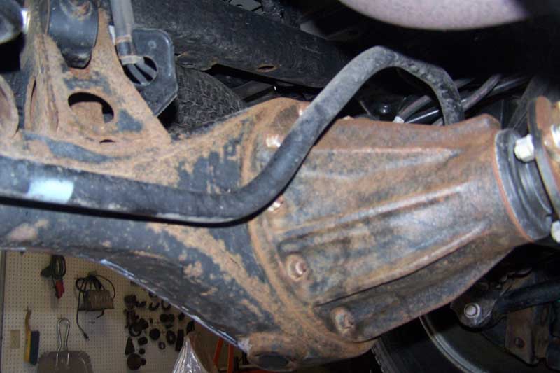

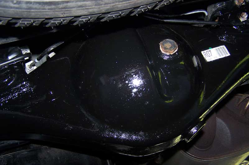

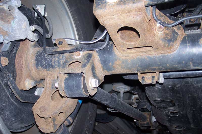

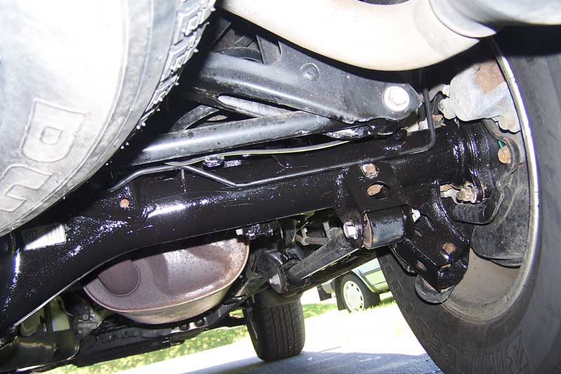

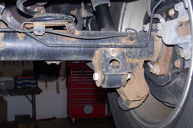

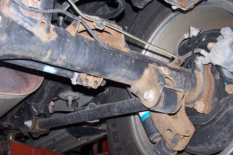

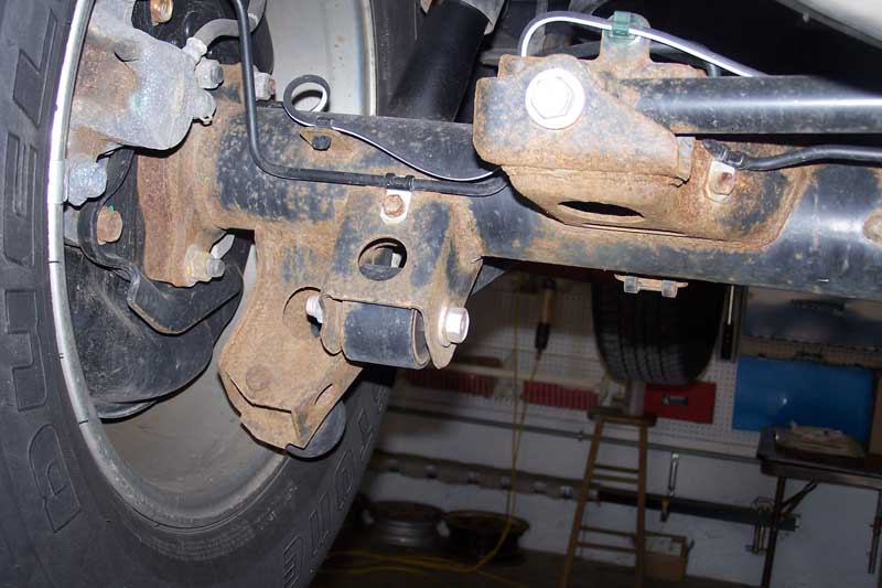

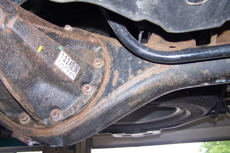

About a month ago I visited a friend who has a shop and a lift.
I took before and after photos of the undercarriage of my 4Runner.
Before Photos:

After Photos:
http://www.gti16v.com/images/4rnra70.jpg
http://www.gti16v.com/images/4rnra71.jpg
http://www.gti16v.com/images/4rnra72.jpg
It took me approximately 6 hours to do the whole procedure.
Had this been one of my auto restoration projects it would have taken considerably longer.
BTW, under normal circumstances one should top coat POR-15 with primer and paint if the area is exposed to sunlight.
Since that is not the case with the undercarriage of my 4Runner I chose not to primer and paint the POR-15 and just left it the natural color.
Wish I could have seen the look on the Toyota Tech's face when he serviced my 4Runner a few weeks ago.
He was probably not used to seeing a 3 year old + 4Runner that did not have a lot of rust on it's undercarriage.

Holy crap....that's a lot of rust. Is this common with 4Runners?
It looks like you sand blasted under there, then threw salt on it :)
Seriously, our 9 year old Honda CRV has maybe 1% the rust shown in those pics. Is Honda that much better prepping their parts, or is Toyota just that much worse?
I'm sure that type of rust won't cause problems, but it sure doesn't look nice.
My 22 year old VW Golf does not have anywhere near the amount of rust the 4Runner had.
Then again, the Golf had a pampered life when it was owned by the first two owners. (ie not a lot of winter driving)
Not sure if it is common or not. Can tell you that my 4Runner seldom/if ever sees the inside of a garage.
I try to wash the undercarriage in winter but that does not happen very often due to freezing temps.
Left untreated, this kind of rust will be a problem at some point.
Since I tend to keep my vehicles a long time, I chose to deal with the rust sooner rather than later.
