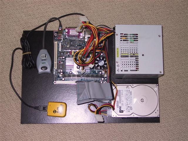

So far I've got the Via EPIA M10000 Nehemia 1GHz mainboard, 80GB HD, 512MB DDR, and a Delorme Earthmate USB GPS. The system runs Media Engine and Street Atlas 2004 on top of XP. For now it just boots into Media Engine and starts playing my MP3/WMA collection on disk. I'll have to wait until I get a monitor to use the GPS part.
For the functional prototype (pictured below) I'm using a standard low-noise ATX supply and an FM modulator to broadcast the music to my stock stereo HU. I power the supply with a coleman 400W inverter plugged into the 12V jack in the back of the truck. The inverter and the ATX supply will be replaced with an OPUS 150W DC to DC ATX supply (on order). The OPUS has an integrated shutdown controller to properly turn off the PC when you turn the ignition off.
I plan to completely remove my HU and custom fit a 7" Lilliput Touchscreen XGA TFT (on order) into the dash. I'll have to throw in an amp or two and probably upgrade the speakers. I'm also going to purchase and integrate an OBD-II scan tool into the sytem. So far, none of the software I've seen for controlling this stuff is very tightly integrated so I expect to write some custom code. I want everything to work seamlessly with voice recognition. Finally, I'll be putting a a DVD drive in for movies and ripping content as well as wireless networking so that I can work on the PC (upload content) from my home computer. I also must install an interlocking mechanism to disable videos and/or games from functioning while the truck is in motion (required by CA law).

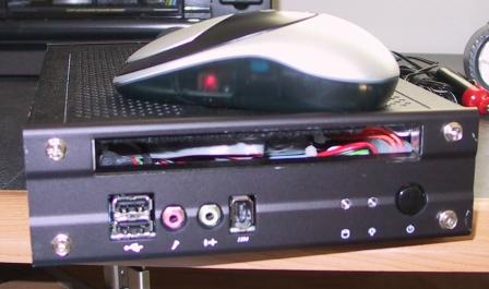

My 7" touchscreen just came in yesterday. This thing is sweet. I now need to start figuring out how to mount it in the dash.
I've also ditched the 3.5" HD in favor of a 2.5" model. Hitachi makes a killer 7200RPM 60GB that's (according to my tests) actually faster than my desktop drives! More importantly, the smaller drive has allowed me to go with an off the shelf case solutions (Travla C134).
I'm now just waiting on a suitable DC-DC power supply solution to arrive from Opus. While I wait, I'm also looking at building a Sproggy 3.5 or 4.0
I'll post updated pics of my setup later today.
