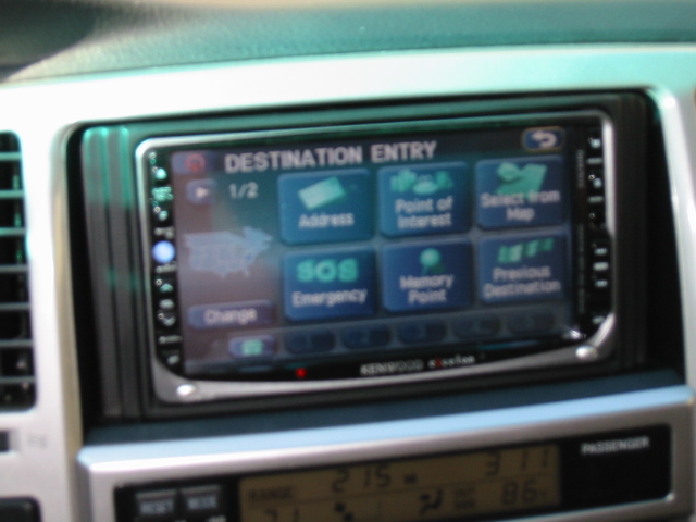

Just installed Kenwood DDX-7015 -Double Din touch screen HU-
Awesome!!! DVD/CD/MP3/CD Changer Contol/AM/FM-etc - fit is good - just working on some trim.Grounded the parking brake wire to the chassis so video displays even when the parking brake is off.It includes a "power" out for the antenna amp.

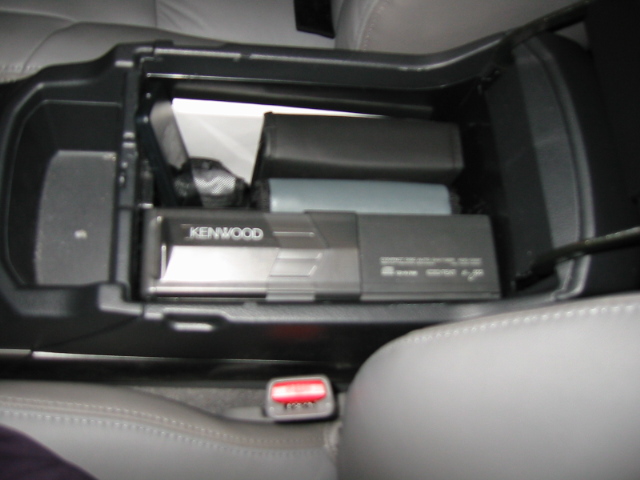

Also installed Kenwood 6 CD Changer KDC-C667 in the armrest - good fit only had to trim an opening at the bottom back of the inside console "bucket"-it is only 1/8" longer than the recommended "toyota" cd changer.
Physical dimensions of the KDC-C667 are 9"3/4 x 2"1/2 x 6"15/16
Physical dimensions for "Toyota" are 9"5/8x 2"3/4x7"1/8

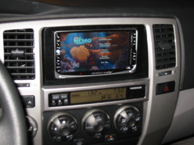

Kenwood DDX7015 Picture
With prototype trim ring installed
Attached wrong picture last post

Now Added Kenwood KNA-DV4100
I have now added an AMP (mounted under the passenger seat) and installed a KNA - DV4100 nav unit (fits great in the little sub-glove box) replaced all speakers and added Sirius radio (tuner mouted in Right Rear storage box). Antennas for both Sirius and Nav unit are located at the very rear top of roof. Everthing works and sounds great.
Kenwood DDX 7015 Trim
I could not find a trim ring to put the double - din HU in. I made several versions using layers of 1/8" baltic birch plywood - ripped pieces , edge glued and sanded to fit - then painted flat black and mounted with double sided tape. Looks great - even the stereo shop was impressed as they could not come up with anything.
Will try to post some pictures this weekend. Only had the std SR5 6 speaker system replaced (extra rear seating positions) so I can not comment on a 10 speaker install.
