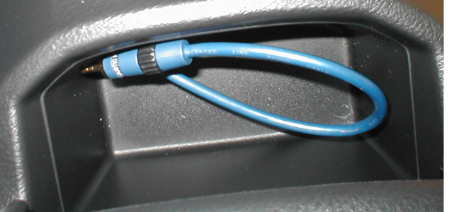

I received the BlitzSafe Aux Input the other day. Best Buy installed it for $52 total. In order to get the mini input to reach back to the armrest, I had another cable installed at the same time. So now I have the iPod input wire in the small coin tray in front of the armrest.

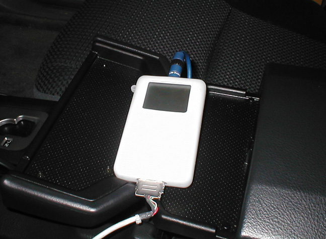

I have the JBL system with the single disk player in my 2004 4Runner. When I select the CD button the radio goes first to the CD I have inside the unit. A second push of the button enables the Aux In, the same way it would enable a CD changer.
So, the BlitzSafe Aux In indeed works with the JBL system. The sound is MUCH better than the crappy cassette input.
The BlitzSafe was $120 delivered. The additional cable (mini to RCA) was $14. Thus the total was $186. Fun comes at a price.

Where is the aux input located on the JBL head unit and was it fairly easy to get to by the Best Buy installere? Also do you have a part # from Blitzsafe. Thanks.
1) Backside of the unit.
2) PITA as he removed a LOT of plastic to do the job. However, the $47+tax was their lowest install price.
3) TOY/AUX DMX V.2

The connection was magic. I took the 4Runner to Best Buy and the lead for the iPod appeared in the coin tray. There was probably a wand involved. The installer had a funny looking hat. All I know is that it works.
I do have to turn the iPod volume all the way up to get the volume to where the head unit can do the rest. The sound levels and quality are fine. Much better than the cassette thing which was a PITA.
