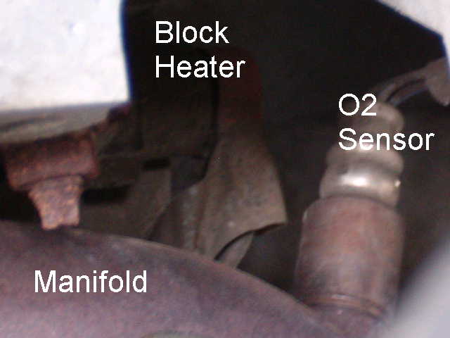

Location is in front of the top O2 sensor.
Here's a pic

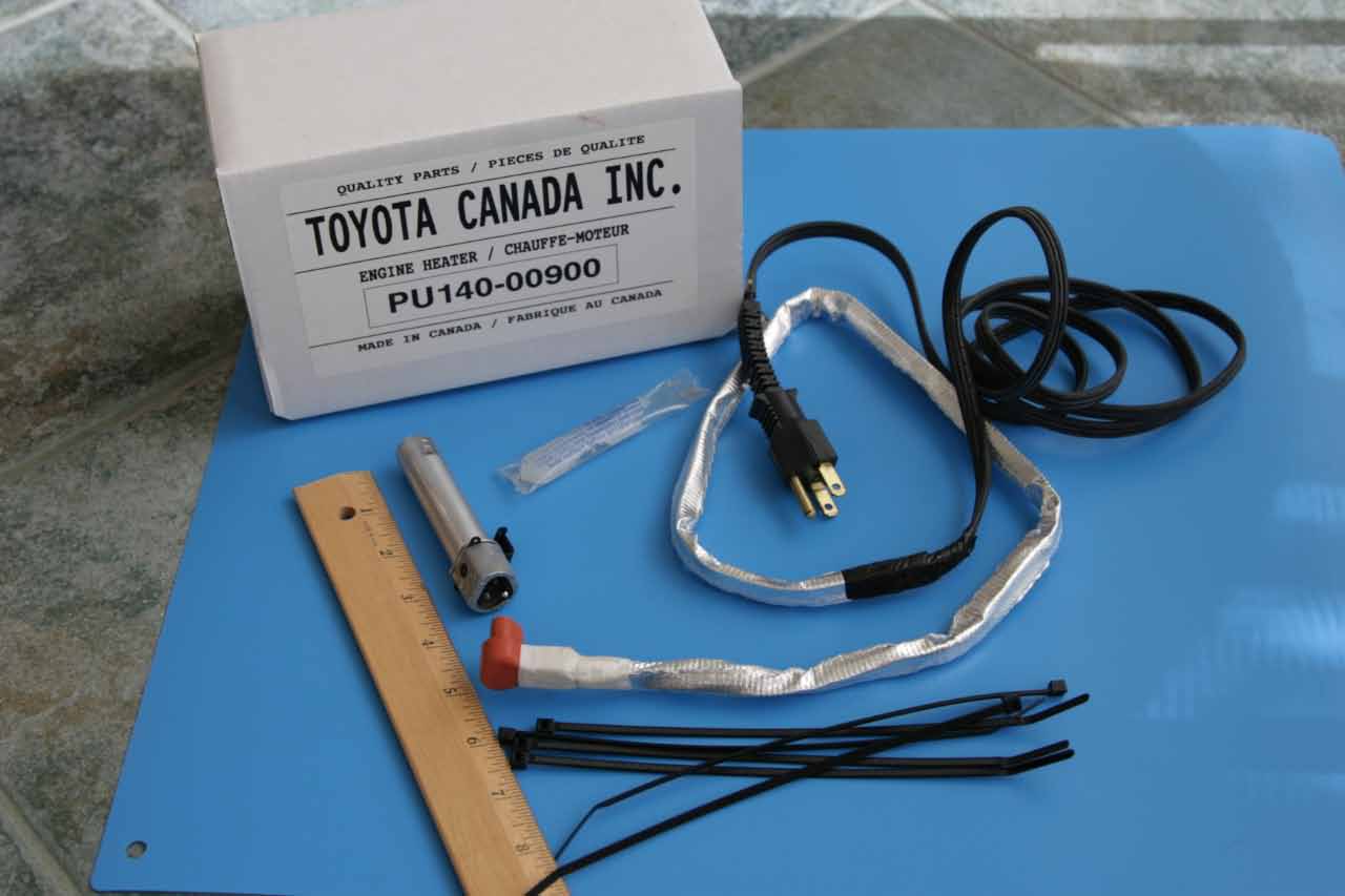

Ok - Here's a recap:
My 2007 4Runner has a V6, 4 liter engine.
Here a pic of the block heater kit I bought. Canadian P/N: PU140-00900. It costs $85 Cdn.

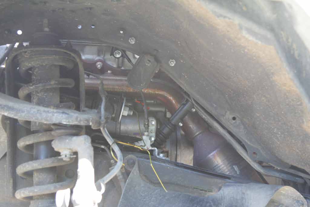

As Kmvreter mentioned - the location to install the heater is at the rear of the engine block on the driver side.
This pic shows the driver side front wheel removed. Notice the spring and shock absorber at left of pic.
The lens is aimed at the driver side of the engine area (with the tires removed).
I've used a part of the coat hanger (with red tape) pointing the part of the engine where I will side the block heater into place.

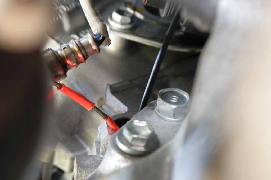

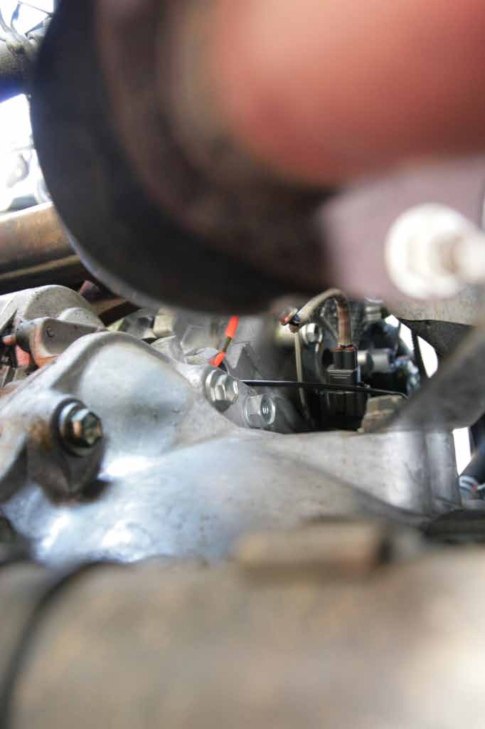

I took this pic from "under" the trunk. Lens is aimed up the rear side of the engine.
Notice the orange tape coat hanger inserted inside the hole. I've also inserted a black tie-wrap to show where the block heater should go.
The block heater is inserted horizontally into that hole. Install it facing forward as mentioned by Kmvreter.

Here's a close-up pic of where the hole is - with orange colored tape on a piece of coat hanger (and that black tie-wrap).
And to say again - this shot was taken from under the truck (not trunk! - typo in previous entry above).
