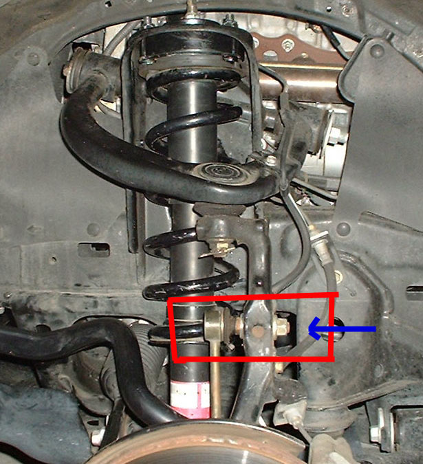

I finally found out the problem. The stabalizer link was not tight. (As I found out) in order to tighten the nut you must insert an allen wrench into the end of the bolt in order to hold it while the nut is tightened.
Hmmm.... Did I say to check your sway bar and sway bar links? :bigok:
