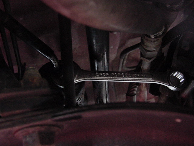

2. Slowly loosen the (nearest to the gas tank) 14mm fuel line going into your fuel filter. You will only be able to turn the wrench 1/4 of a turn. let the fuel drip into your catch pan, losen more and more untill no more fuel drips out and then losen completly.the threads are about 3/4 in. long so be patient.( takes about 10 mins.)

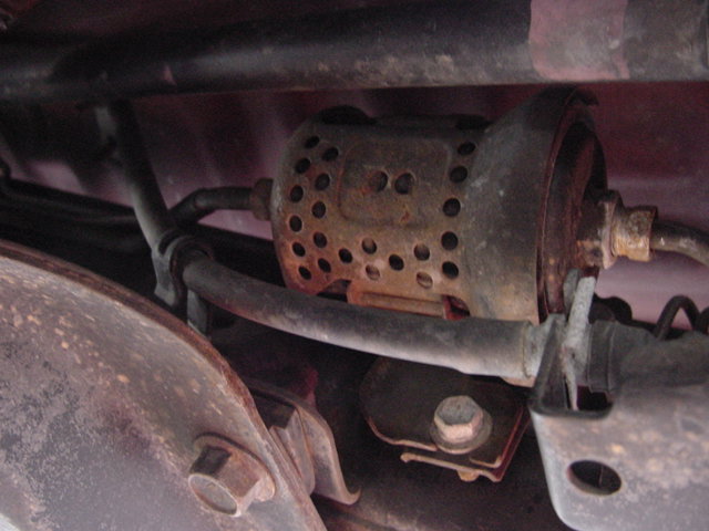

3. next loosen the front(nearest to the engine) 14mm fuel line going into the fuel filter, you should have little to no fuel spilage at all. again the threads are 3/4in. so be patient.

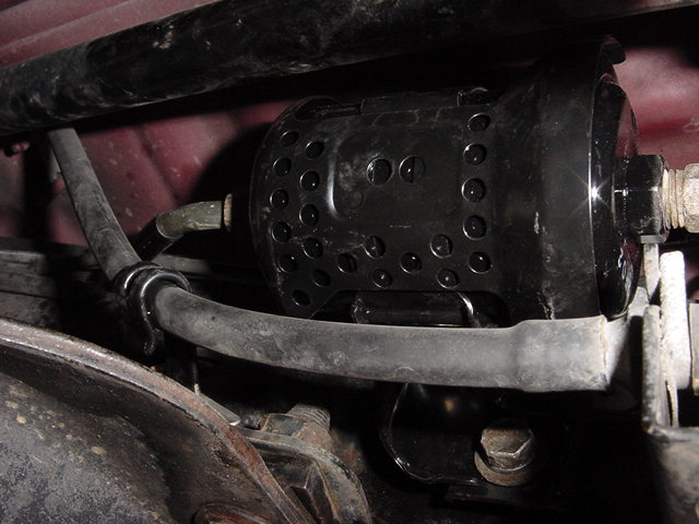

4. Next loosen the top 12mm bolt holding your fuel filter on. This is the bolt you will need the socket swivel and extension for.
then losen the botom 12mm bolt.

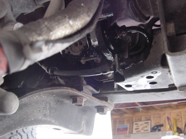

5. Remove the fuel filter from the top, be careful as some fuel that is trapped in the fuel filter will come out.
LinkPhoto
