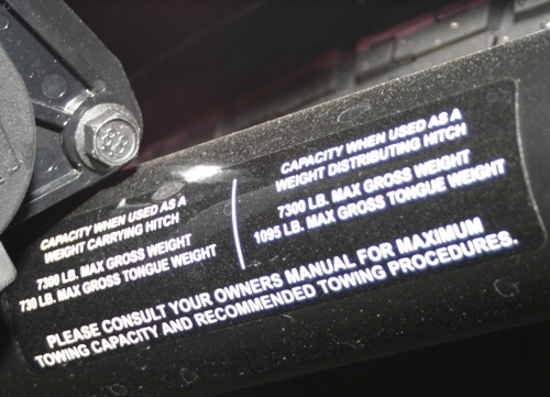

The first thing I would do is check the manual. My guess is you can safely tow 7300 pounds. I have a 2004 Limited V8, and that is what my hitch has printed on it.

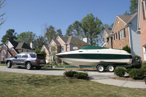

Today I pulled my boat 30 miles up to the lake with NO problems. Total weight of boat, trailer, and gear is 6500 pounds.

You also need to read the owner's manual. Some things in the manual supercede (and don't reconcile) to whats printed on the hitch. For example: 7300 Gross distributing weight if its two wheel drive 7000 pounds for 4 wheel drive. And weight carrying in the manual is 5000, weight distributing is 7000 (for 4X4)
At least reading my '04 V8 4x4 manual. Don't know about others.
But the hitch sticker does disclose to read the manual first. Which is where the manual has the final say.
The 4R will tow about anything but its where the braking (emergency or otherwise) comes into play that you will wish you were in compliance to the manual. At least if something went awry Toyota NA would be responsible and not you personally. I don't believe given the dead weight and gross vehicle weight of the 4R it would safely tow anything over 5000lbs. without a weight distributing hitch. (contrary to what the decal shows above about 7300lbs. for a weight carrying rating) That may be the hitches, but I doubt it would disclose that spec in the manual.

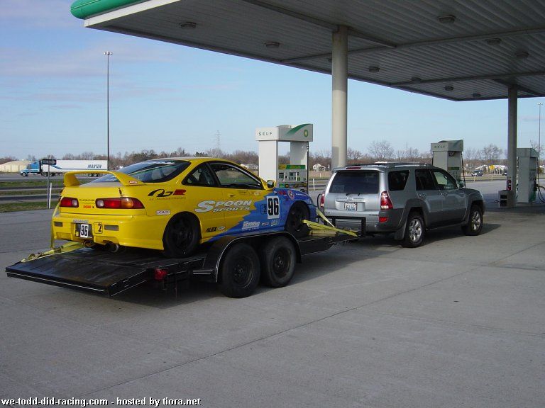

I've towed over 1000 miles last month to different tracks with my 4Runner. I have no WD hitch and the total trailer weight was approximately 4000 lbs. It towed great. :)
