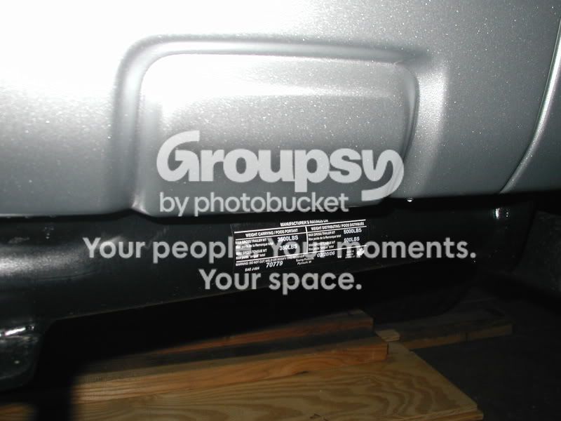

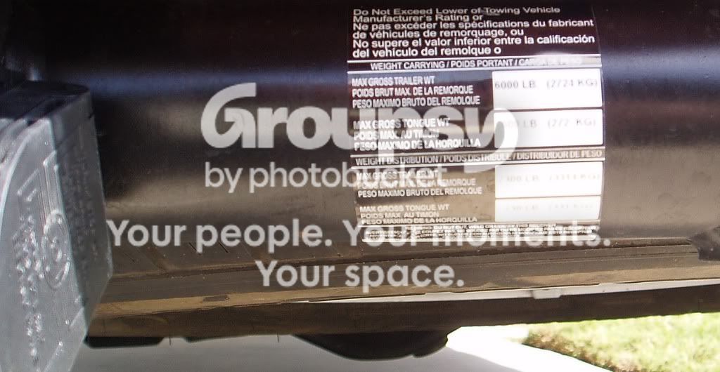

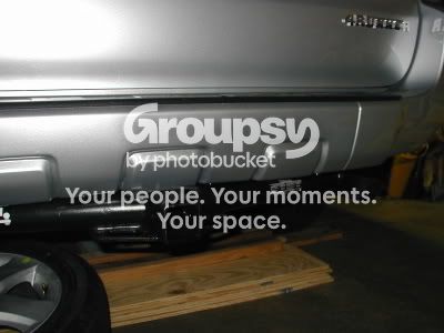

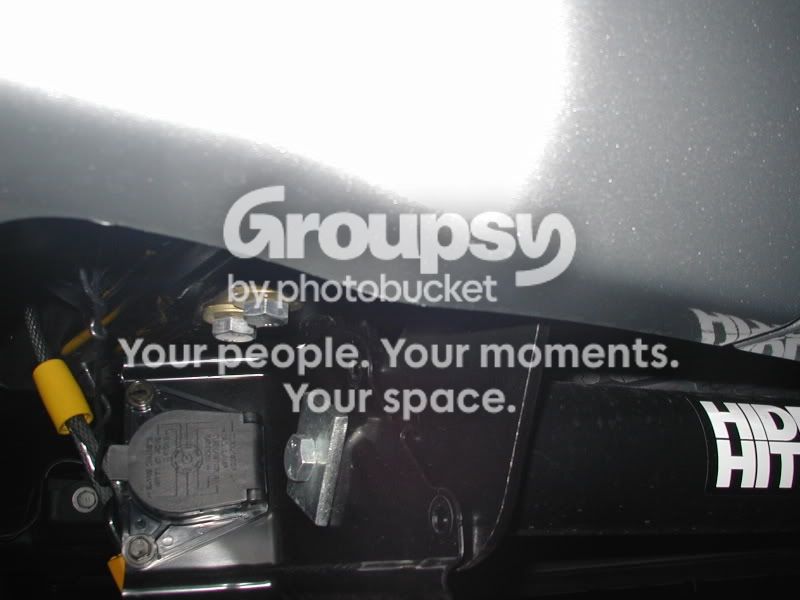

CJ3Flyr,
Does your hitch look like this?
Label
Relocated hitch wiring plug

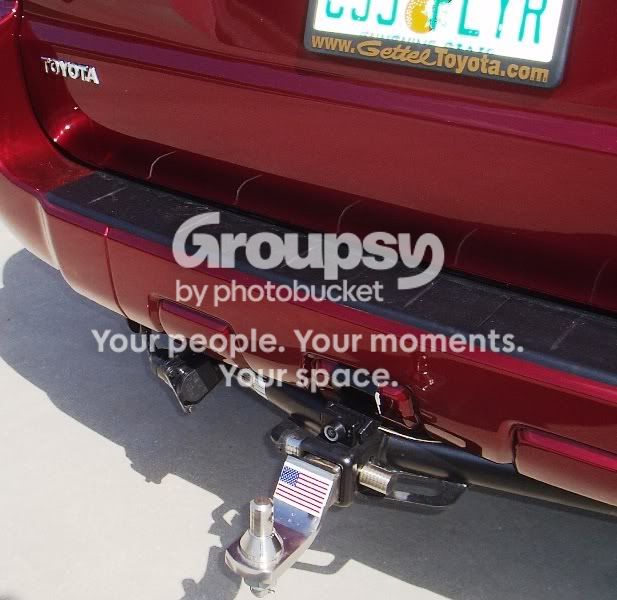

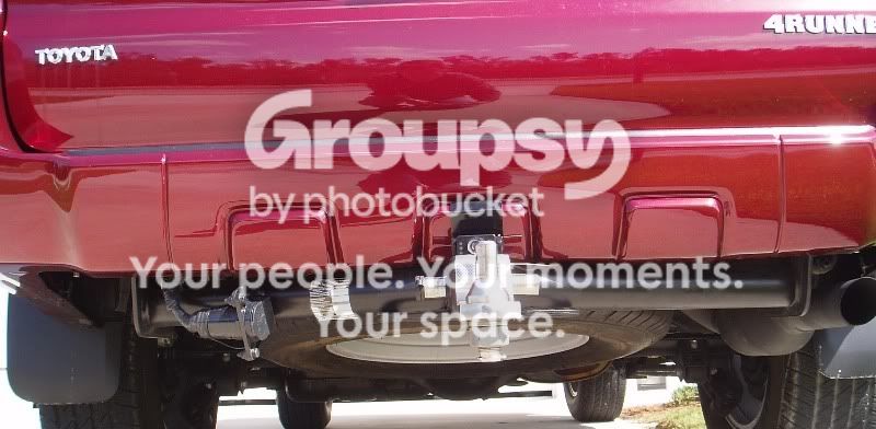

My hitch is as follows:
Upon further review the hardcore off-roader may not like my hitch. The light plug does hang down some, not as bad as others I've seen though
Check this on towing limits for the V6... LV4R's reply sums it up. It's about the 12th one down. http://www.toyota-4runner.org/showth...threadid=41389

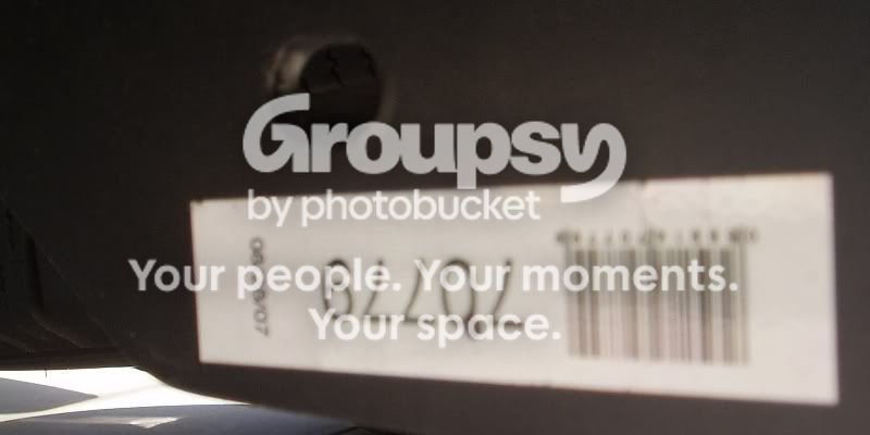

CJ3Flyr,
HiddenHitch must've made some changes/upgrades to it. I would think they did since they discontinued the 70411 and there would be no reason for a V6 owner to upgrade to their 70779 if the capacity is the same as stock. Mine doesn't relocate the hitch harness either. The bolt and plate is all they provided to mount the hitch, thus I no longer have the tie down in the rear.
My bar code label like yours says 17/02/06, but the tag with capacities show 02/20/06. I got the hitch in May '06 a couple months after getting the 4Runner.
Yours appear to be the same shape/style as mine, even to how it pushes the bumper up slightly too. At least no cutting is required.
