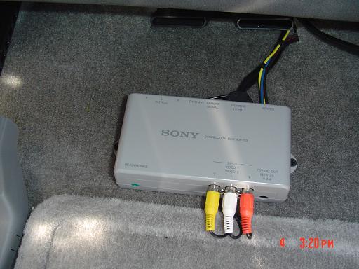

control box
this will also allow us to plug in the A/V cords for the PS2

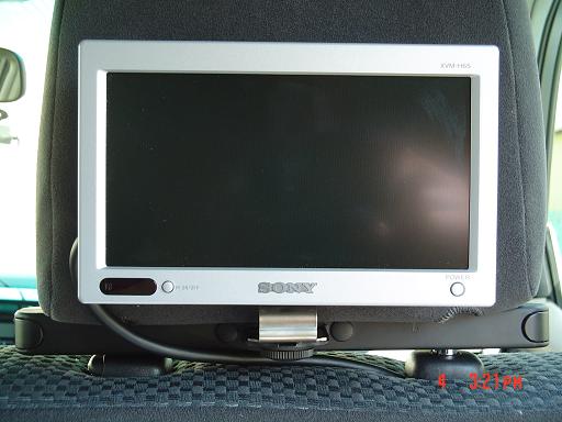

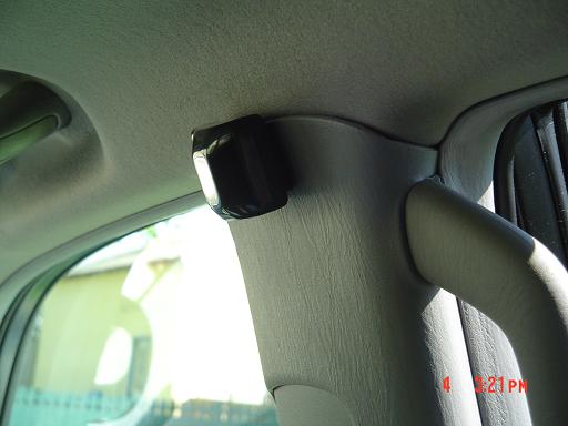

remote sensor
this will allow my son to operate the dvd player; fast forward, reverse, without having to worry about glove comparment being open or shut.

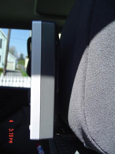

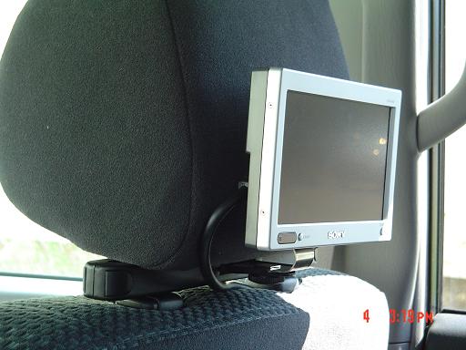

another shot of the monitor
just wish the head rests were a little wider. The height is ok, but not enough meat on the sides to allow for the install of the flush bracket

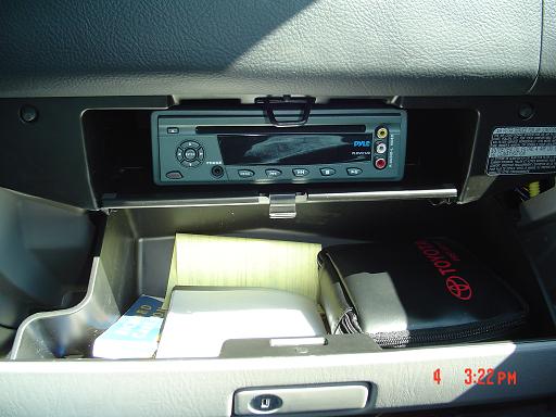

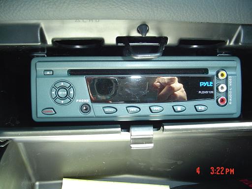

Dvd player
here is where we decided to mount the player.
gives my wife control
1. with what my son watches
2. with ultimate control of the power switch

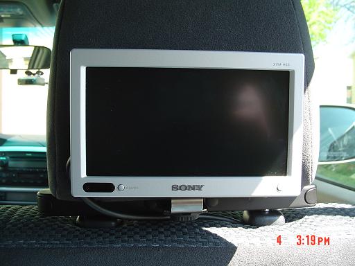

another shot
now I need to put the 1st aid kit somewhere in the cargo area. probably with the cargo neting and tie down straps I have

We are still looking into after market headrests, so we can fit the monitor inside of it, I will do that part of it myself.

Nice install job! I have an inexpensive Pyramid MV7SC 7" monitor along w/ a Pyle DVD/TV tuner -- couldn't justify higher cost of a good monitor for a 3yr old! I ended up mounting my dvd player under the passenger seat as it wouldn't fit in the glovebox. (it also has a built in tv tuner) Have the tv antenna mounted across the rear seat backs since I didn't want to mess w/ a windshield or headliner installation. Also, I got a 3 way 12v lighter adapter and tapped power off the REAR 12V socket, and ran the wiring under the rear cargo side trim, down behind the rear seat and under the door threshhold... its all completely hidden except for the plugs and a few wires wraped with wire loom. Since it's on an accessory outlet, it goes off w/ the ignition. I have a set of wired headphones along w/ an FM modulator that can be used w/ the factory wireless rear seat audio depending on if we want to listen to the radio or not.. if we're listening the radio, then the child uses the wired headphones...
