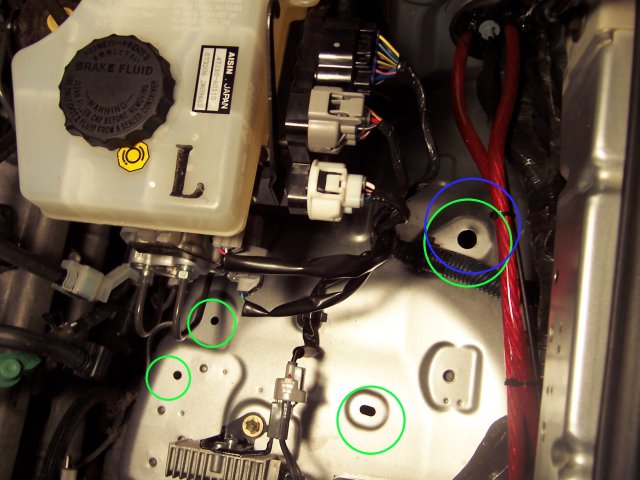

Hopefully, the '04 has been properly patched. Open your hood and make sure that there is light shining down on one of the wheel wells. Now, put your head near the top of that tire and look up into the wheel well. If it was like mine, you should see a 5/8" hole almodt dead center on top, plus a couple of other little bastards. Drive through some mud and you'll be amazed ay how much of it ends up in the engine bay.

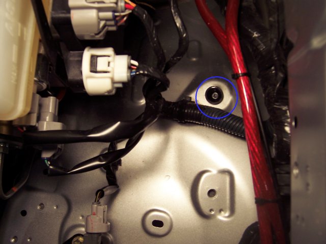

Below is a pic of the drivers front wheel well and the feature of having several holes. I'll post another pic with the largest hole plugged. The plugs seem to work well.

The plug for those holes is 90950-01955. It is for the larger size round holes. Look on the pass side firewall, you will see where they use this plug. I am going to get some on Wednesday, I will see if they have something for the oval holes.

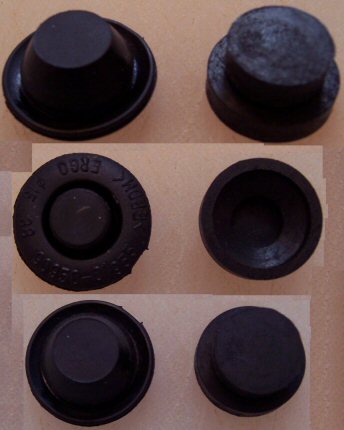

Toyota plug on the left, Home Depot on the right. Toyota is obviously more appealing to the eye, Home Depot might be less costly and more convenient.
Both will protrude into the wheel wheel by about 1/4" or less.
