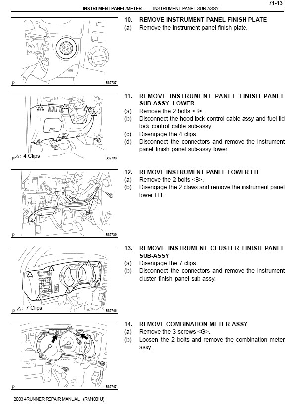

I have an '04 4Runner, so I'm not sure how much different this is going to be than for your MY, but it was pretty easy for me.
I followed the directions in the attached pdf. It took me probably 20 minutes total.

hey guys. It's really not difficult to change out the inst cluster / plastic lens. Mostly it just snaps in, and once you get it out, I believe there are three connectors, and to get it taken apart further there are some small screws (con't remember if they are phillips or torx).
