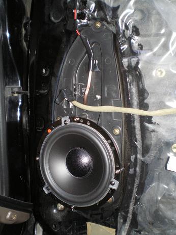

I was just curious as to what the factory speaker bracket looks like in the door. Even a snapshot picture would help, google images has nothing for a 2001 :(
No factory speakers anymore but I do have the factory plate still. I used an adapter plate that came with my new speakers and it mounted right up.
Sweet, So you're using 6.5" in the fronts with the factory plate? If so, then cool cause i dont have to buy any extra adapters for that i hope. I still gather that i need the rear door adapters to go from 4" to 5.25" back there eh? That is most helpful for sure, i'm trying to buy all my installation parts online and i want to have everything i need once I start taking things apart. Thanks for posting that :bigok:
Also, what about the tweeter pods.. Will most any 1" tweet fit in there? I notice some are smaller than 1" depending on brands.
Yeah those are my Boston 6.5s you see. The tweets took a little while to figure out a good fit but I ended up using the factory bracket and just shaving down the tweet mounting cup that was included. And yes, I imagine just about any 1" will sit in there nicely. For the rears I used the factory rear plate and just modified it by cutting out a larger opening and sanding down the ribbing so the speaker would sit flush. The rear plate also had a clip mount for the speaker connector that I had to shave off. Nothing too serious and relatively easy. I can get you a pic of that as well if you need a visual.
Ahh, Bostons... I thought they looked familiar! (i currently have some MB Quarts i pulled out of my car, same looking mounting ring) I had forgotten about those tho, been so long since i've bought new car audio stuff. I may see how much a set of those go for in front and rear :p I like a stout speaker that can handle a good bit of mid drive as well.
I might just go ahead and order the back adapter plates, just so i can keep the factory ones on backup. I'm going to get the speaker harnesses too so i don't have to cut anything.
A pic would be good for reference tho :nerd:

I only added the pioneer head unit, all amp wiring, and installed the sub and sub amp. I used the radio harness but i'm still shopping for the door speaker replacements (not sure what i want yet.)
I modified my factory plate to fit 5.25s in the rear. You wouldn't fit 6.5s without cutting into the door as the 5.25s just barely squeezed in.
I laid a template over it for my cut out diameter and then had to sand down the ribbing and shave off a plastic clip holder for the speaker wire plug. This was just to allow the speaker to sit flush and form a good seal. It was pretty easy and works really well.
