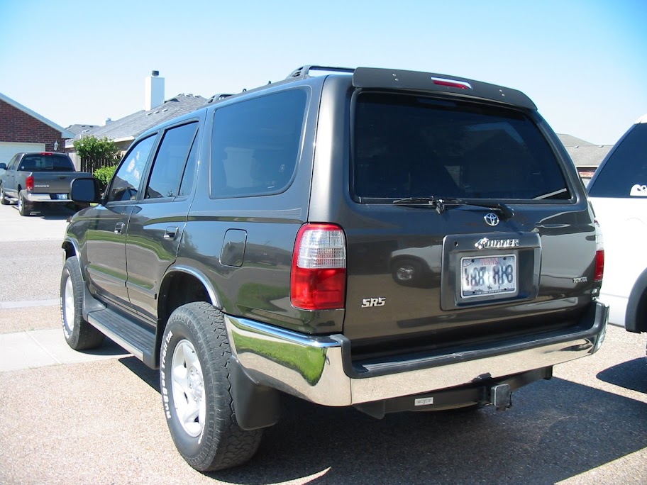

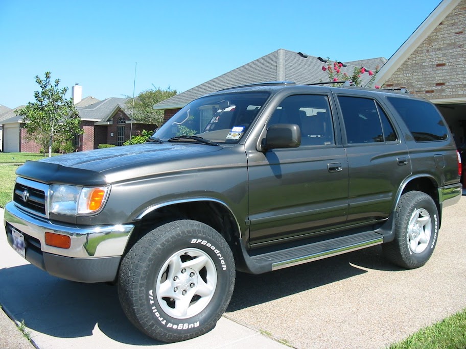

Update!
I've been spending more and more time over on YT/Marlin/Pirate, but I can't forget where I first started!
Here's some pics w/ updates:
Old Betsy:

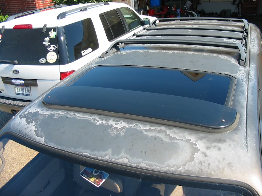

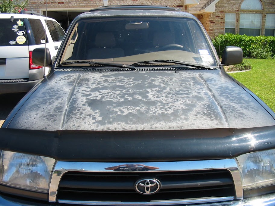

She has some hood and roof issues:

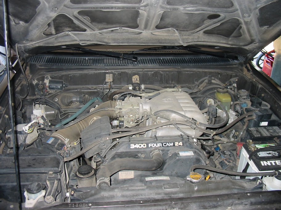

Engine a little dirty (nothing a good cleaning can't fix!):

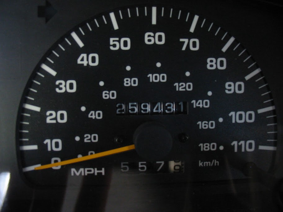

Compare the miles...ya think it's time to replace it again? :D

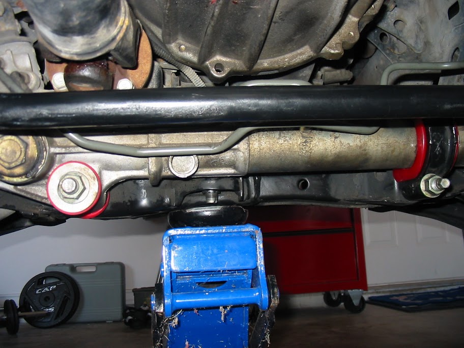

Just finished steering rack & swaybar bushing replacment:

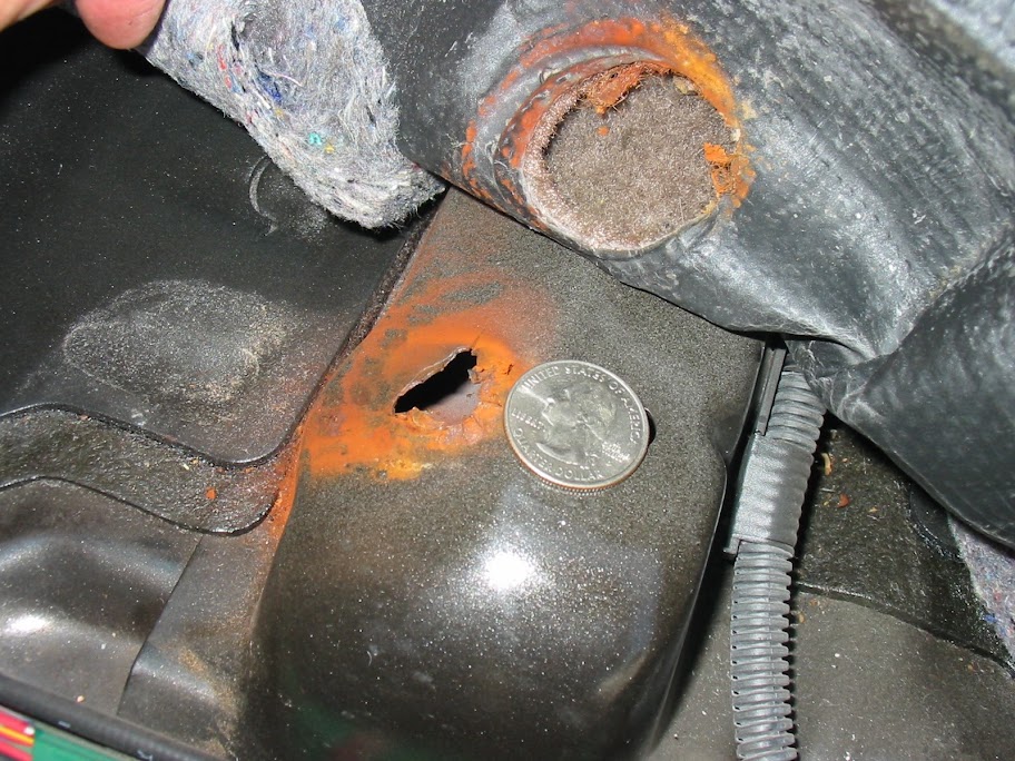

Now I need to fix this! (Seat mount):
