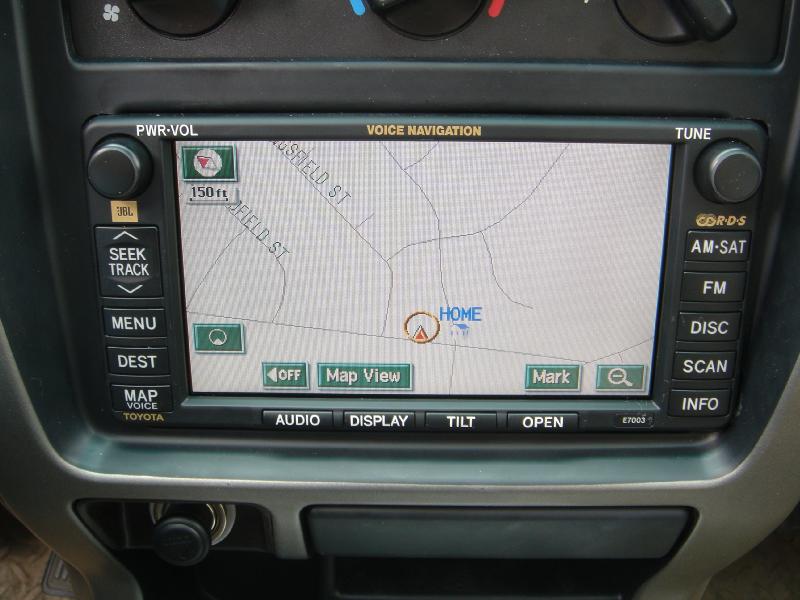

I have been perusing this forum for a while. I have a 2001 4Runner Sport and have always wanted navigation for it. I have seen the offerings as far as aftermarket and I was not impressed. My goal is to keep my vehicle as factory looking as possible.
Last week I stumbled across an item on Ebay that fit my needs perfectly. This was an OEM navigation unit from a 2004 Camry. This unit was brand new and has been successfully retrofitted in many other Toyotas, however never a 3rd gen that I know of. To make a long story short, I bought it, installed it, and it is AWESOME!!
There is a bit of cutting required to make it physically fit in the dash since the unit itself is about 3/4" wider than the factory deck. However the end result is well worth it!
The site where I bought my unit from is OEMValue. The price is roughtly $1650 shipped. Below is a link to the pictures of how it looks installed:
Navigation Pics
Let me know if any of you have any questions.
Jim

That is "WAY COOL" . My only question is what happens to the radio and CD player? It looks like it doubles as a radio, CD player also. Can you listen to a CD and use the map? If it does have a radio & CD player, is the sound any good?

It has all the features of the original headunit - AM/FM CD with all the features. The CD slot is behind the motorized faceplate. The only aspect that it is missing from the old HU is the cassette player, however I hardly ever used that anyway. The sound is about the same if not a little better than the old stock headunit.
