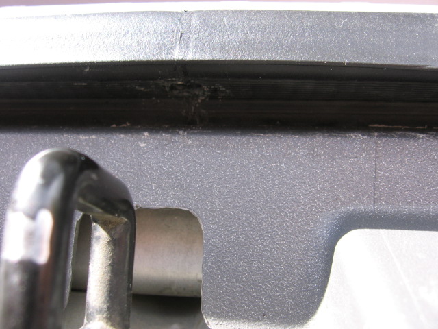

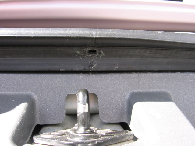

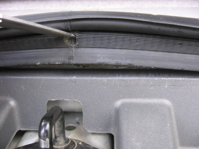

I had read about this potential issue a while ago and decided to have a look for myself. I was surprised to find that even in my mild climate, minimal off-roading, no spills, no rains with the windows down that my T4R has a developing issue. The factory weather-strip seems to trap water along the bottom edge of the tailgate seal and sets the body up for some rust development.:bugeye:
Rather than hassle with Toyota I decided to proactively address the issue. I may have shot myself in the foot but I promise, it won't be an issue for me, ever. I will continue to watch and address it as necessary.
TailGt1.jpg~original
TailGt2.jpg~original
TailGt3.jpg~original
TailGt4.jpg~original
After swabbing out the nasty stuff I cut a little hole in the bottom of the strip to function as a drain. There was a substantial amout of water along the strip. With the OEM setup there's no place for the water to get out. Based on where this strip is and the bumper etc the only way that my hole let water in is to swamp the whole vehicle. I guess a 2nd way would be to lower the spare and aim a pressure washer at the top, underside of the bumper and I'm not sure that would do it...

Wow, that is crazy. I still would have brought it to the dealers attention. They do have a body rust warranty don't they and to think it's only a year old.
I hear ya... My rust was very minor surface rust that was on it's way to being an issue. I am not saying you're wrong it just wasn't the path for me.
IMHO the dealer would have wiped it down and maybe put some treatment on it and told me I was good to go. I know it would have involved 2 trips, 1 for assessment and one for the fix.
My point of the post was to plant the seed to check yours not to suggest I had the "only" fix...:D
What's "right" and what gets the job done is often different. Perception is 99% of reality many times. My "reality" is this was the quickest, most effective, most permanent fix available.
:cheers:
