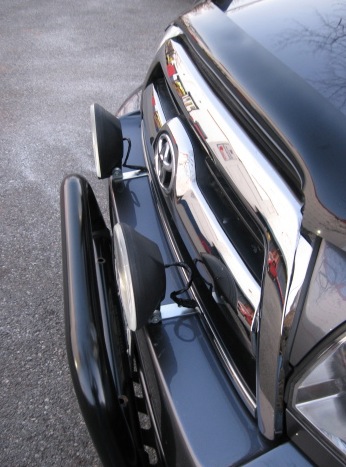

Alright guys so here is my first write up on how I mounted my hellas.
For this project, I used 6" x 1-1/8" L brackets, 1 1/2 inch bolts, and proper fitting nuts and washers.
First, the mounting bolts that come with the Hellas are much thicker than the hole in the L brackets. To accommodate for this, you will have to drill into the L bracket and make the hole bigger.
Second, you will have to drill into the bumper. However, I drilled where if I take the hellas off, the holes will not be noticeable. The black plastic piece under the hood is 36" long. So, measure 9" from each side and make a mark in the middle. This will be where you drill.
Attach your hellas to the L brackets, and you're ready for mounting!
Here are a couple pictures of the finished product!
Picture024.jpg~original
If you notice the mark by the bolt in the picture above, that is simply dirty water, that is NOT a scratch. :D
Picture025.jpg~original
One thing to note is that the bolt will rub on the bumper. I simply bought some rubber bolt caps put them on and this first week kept an eye on them and haven't had any problems so far. Went off roading today and they were extremely stable.
I'm sorry I didn't take more pictures throughout the process. Let me know if you guys need any more information.

Kraeken, absolutely LOVE them still. No rust, no wiggle, nothing. The hood opens and shuts without hitting the lights and looks very cool. I just went on a road trip to WA and they were sturdy and helped so much. Driving through Idaho I hit some deep fog and flipped them on and was able to see clear as day.

Noloc, I purchased the L brackets from a local Ace hardware. I couldn't seem to find any that I liked at a Home Depot. They were all too big or too small.
And yes, there is only one bolt. No bolts on the inside at all. I thought that I might have some movement due to only one bolt but if you get it tight enough they are perfectly fine.

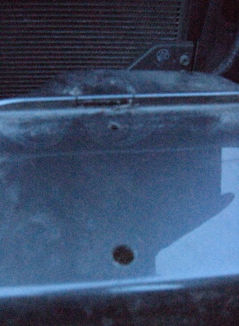

Guys, I am sorry!! I just realized I forgot one step. The hole I have the bolt in (circled in red below) had to be drilled. If I used the one in front, the hood hit it when opening and shutting and if I used the one behind it, it stuck out and looked horrible.
Sorry about that guys. Here's the picture.
Picture025Marked.jpg~original
Doug
