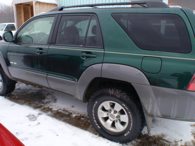

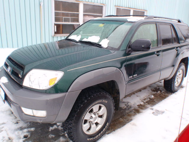

I run 265/75-16 (32") BFG ATs and have no rubbing at all. I put my lift on after the tires. My lift: 4 FJC springs, 2" front spacer (1" spacer thickness). The difference from front to rear is the rear sits about a 1/4" higher. I personally would like to raise the rear about a half inch to get some rack back. I do not tow very often and I usually do not have the back loaded so it isn't worth me pulling the front springs. My opinion would be to raise the front about 1.5". Which would be a .75" spacer. Hope this helps.

As far as the BFG's, I can honestly say my next set of tires will be the same. I have heard they are not as good as others in the rain. That by no means, mean the are not good in rain. With the snow, slush, sleet, and rain we get here in Maine, I feel they are a top notch, complete package tire. I know many people that have gone with other "better rated" tires, just to go back to the BFG. It all depends on what look, ride, and road type you are going for.
These were taken just after the lift.
http://www.toyota-4runner.org/showthread.php?s=&threadid=44362
these were taken today, running boards removed.
