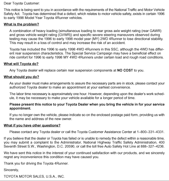

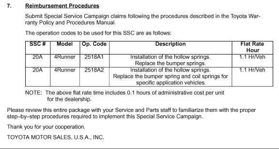

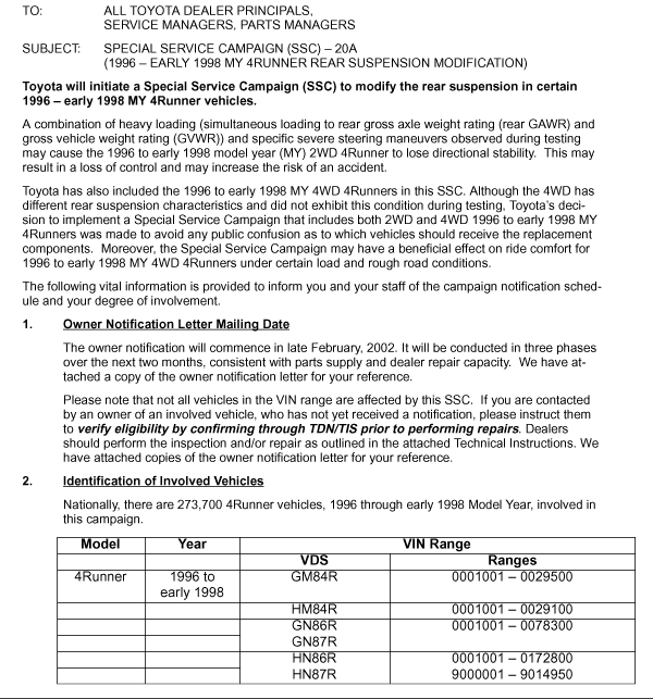

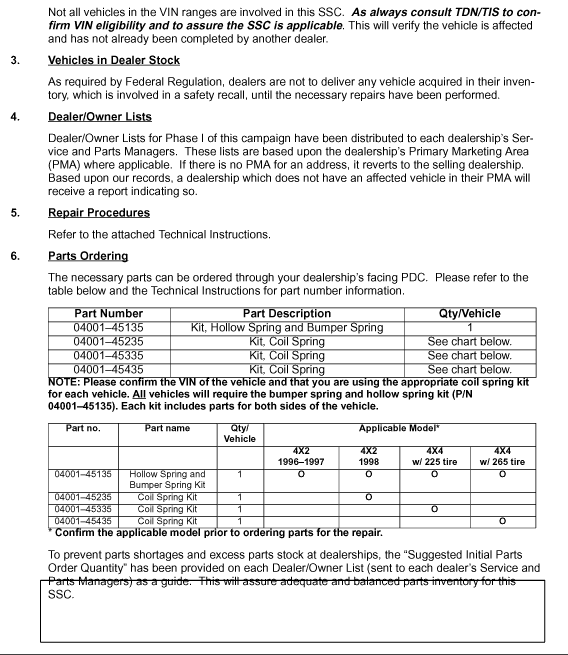

96 to 98's have had the rear coils recalled. You can take it to a stealership and get them replaced for free.
this is the dealer letter feel free to print so its easy for the dealer and they dont try to Bull $**T you
1.gif~original
3.gif~original
this is the customers recall
4.gif~original
I called the local dealership and the guy there said he didn't think there were any recalls on my 96 (b.s.). Shootmymime, all I see is red x's on your post. Since I would love to get my rig fixed for free, can you tell me what you posted there? Or a link or something? I need to get it done soon my left side rear is lower than the right side.

I checked the VIN and I'm square in the middle of the '96 range. I'm assuming it shouldn't matter if it's US or Canada, other than odometer and DRL's it's still the same truck so should get the same fixes?
that is a really helpful post
shoot my mime that is most helpful
mods-this could be a sticky?
just as applicable as the "99 mid year upgrades"

Has anyone actually been through this process? Also, what is the VDS in the VIN number range? Bringing copies of those into the dealership parts and service department should be enough to get this done? This is majorly helpful thanks!
Sooooooo I went to my local dealership today (Toyota of Kirkland) and brought my copies of the recall and they looked it up on their computers and I found out the fix has already been done on my 4Runner. That's the dumbest thing I've ever heard. They replaced my recalled springs in '02 with springs that need to be recalled. Man I'm pissed. Can I argue that at all? I don't feel like I should be paying to replace my springs.

Ya I always hated the way the rear of the T4R sagged. I saw that the recall letter was focusing on the 2WD but that they would replace the 4WD ones as well. I jumped on that ASAP. Hey new free replacment parts always welcome.
