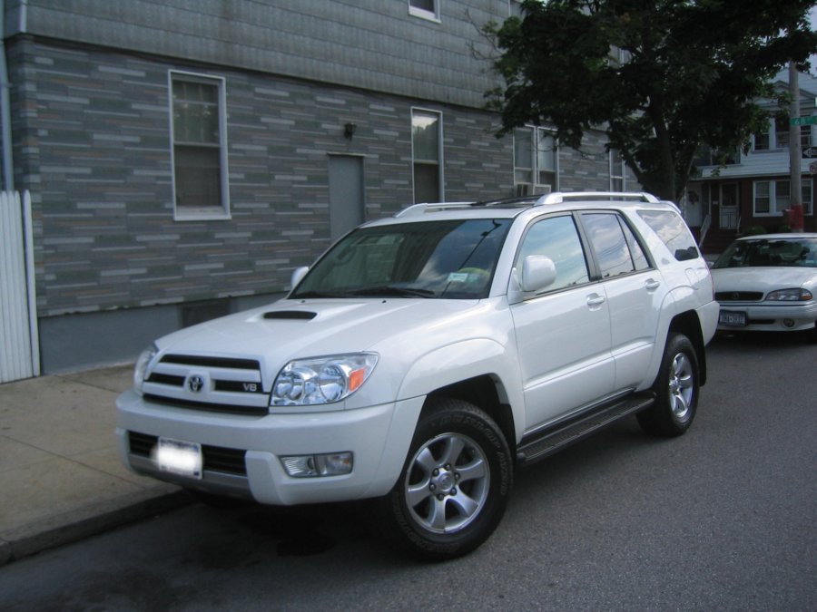

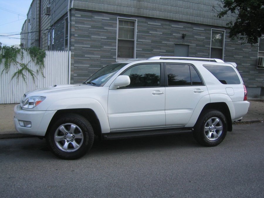

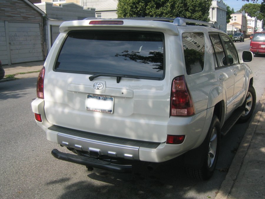

debadged white
slyangel9
one big blister later from all that adhesive
oooooh....vera nauuce... I think I might debadge the sides of mine. I like the toyota and 4runner on the back, so I might leave them. ya know...it lets the people who are behind me know what they are being smoked (or towed) by.... :D
wow it looks really good! i'm considering debadging mine, but i think i'd only take off the "toyota" in the back.
it is so much cleaner now...i hated the way the rain water left streaks under EACH letter. It was madning. Even after i washed the car, the streaks were still there. I used Bug & Tar remover to polish the area. After a rain soaked weekend, there were no visual marks left. Not even an "ghost image".
:clap:
Looks great! Now I'm considering taking 'em off the sides. That white sure does grow on you after a few pics. Not too many around here to compare with. Perhaps in the future as I've never owned a white vehicle but it looks damn good on a Runner!
i took mine off today to paint, and man, my fingers are torn up! either from that or all the wheel painting i've been doing lately.
your white truck looks very nice and clean!! :)
to prevent blisters and the skin on your fingers, I suggest you use a rag (scratch free of course) and bug and tar remover ($3.00). This will help clean up the small adhesive.
